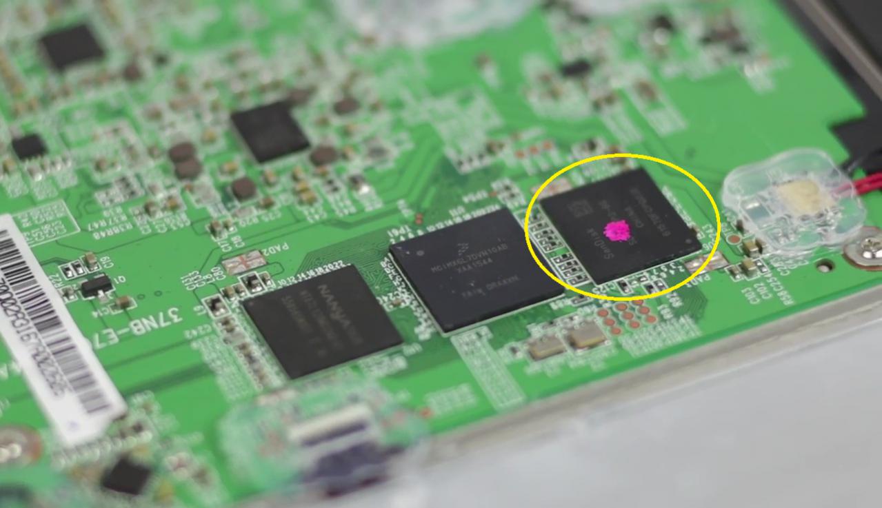

Posts: 48,503
Karma: 174510108
Originally Posted by Readirect View Post
Actually, you were correct the first time. The KA1 does indeed use an (internal) SD card for its storage.
Not quite right. The KA1 uses a soldered SanDisk eMMC module for it's storage. See the circled chip in the attached images.
Old 06-15-2019, 10:18 PM   #12
davidfor
Posts: 24,905
Karma: 47303824
Location: Sydney, Australia
As @DNSB showed, the Kobo Aura ONE definitely does not have removable internal storage. The OS largely treats it as if was a removable SD card, but it isn't.
Or do you mean another device by "KA1"? If so, I can't work out which it would be. The only one that I can think of is the original Kobo Aura. That could be referred to as the "Kobo Aura Edition 1" and hence abbreviated as "KA1". But it has fixed internal storage as well.
