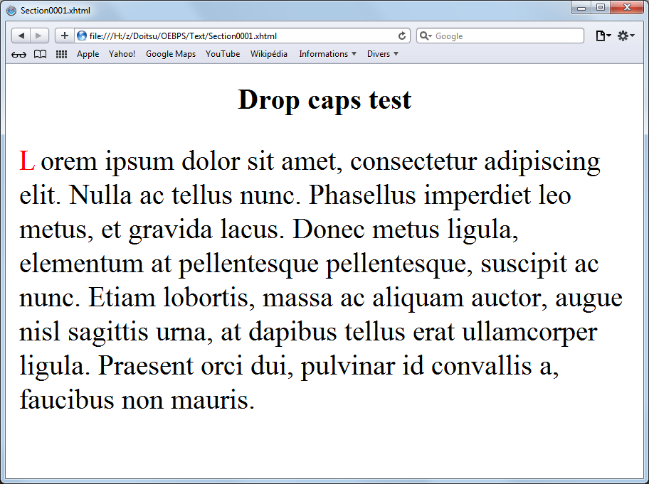

For example: Spoiler:
However, I've found only one app that actually supports this new rule: iBooks. ![]() EDIT: Gitden Reader also supports initial-letter, but not ADEPT DRM. Last edited by Doitsu; 05-18-2019 at 04:58 PM. |

I haven't got the faintest idea how to do this, I merely adapted the website code for epub3 books. (I won't use drop caps CSS, until initial-letter becomes widely adopted.)
I didn't mention this issue, because I assumed that it'd be obvious to ebook designers familiar with pseudo selectors. |

dropcap_chars: 1, dropcap_lines: 3, Where dropcap_chars indicates how many initial characters of the paragraph should be drop caps and dropcap_lines indicates how many lines high to make it. The drop cap automatically adjusts to the font, font size, line height, etc. (Do you have any idea whether initial-letter is on a track to being standardized? The article that you linked is over three years old.) Last edited by jhowell; 05-19-2019 at 04:37 PM. |

And seemingly not even on Safari 5.1.7, the outdated last version for Windows. |
