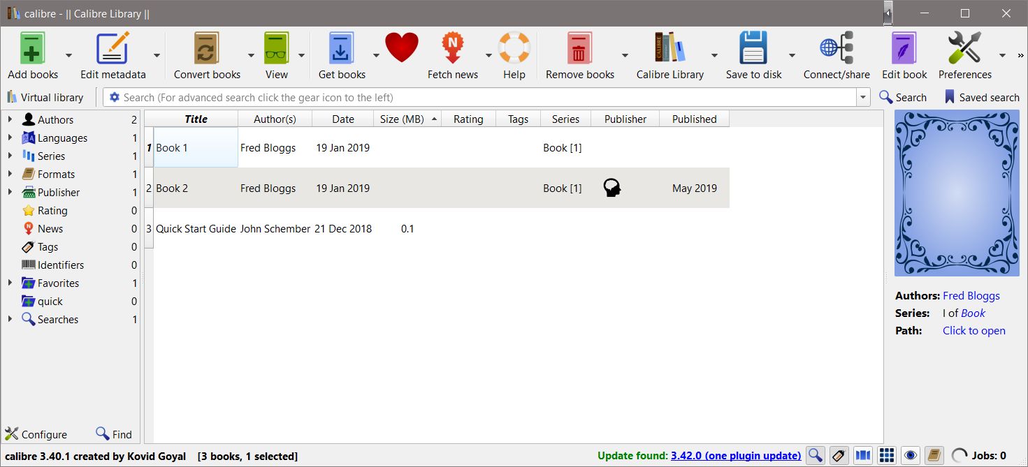

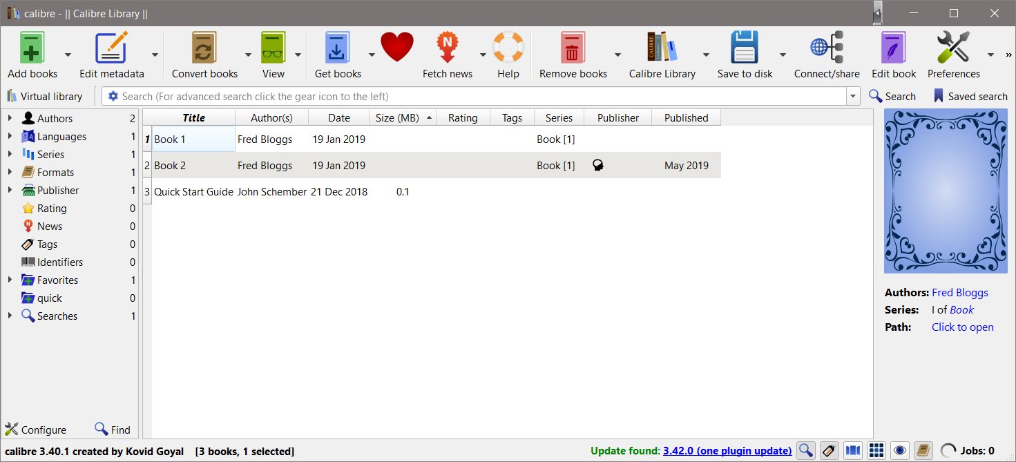

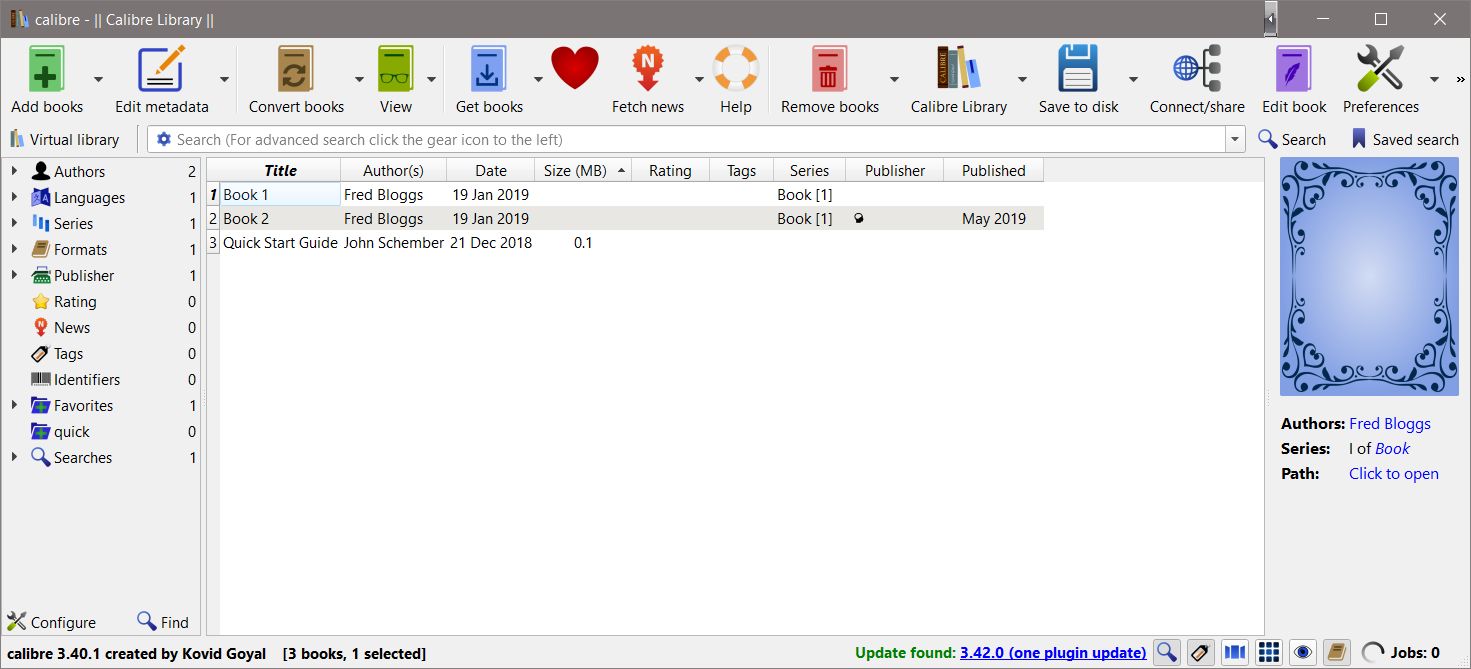

I have 128x128 png icons, the size adjusts to the line height - here are 0, +20 and -20 px adjustments

I spent some time with this tonight and I was able to remove my icons (sigh) and the inter-line gap was less, although I only got four more lines doing so. It still wasn't tight with the 8-pt text still having visible space within the every-other line background grid (thanks to DaltonST, again, for that Customize GUI capability). I understand the need to limit we users from going TOOO crazy with line height adjustments, ergo the min and max on the setting. It's just too bad that I'm once again the guy with a specific need that nobody else needs.
