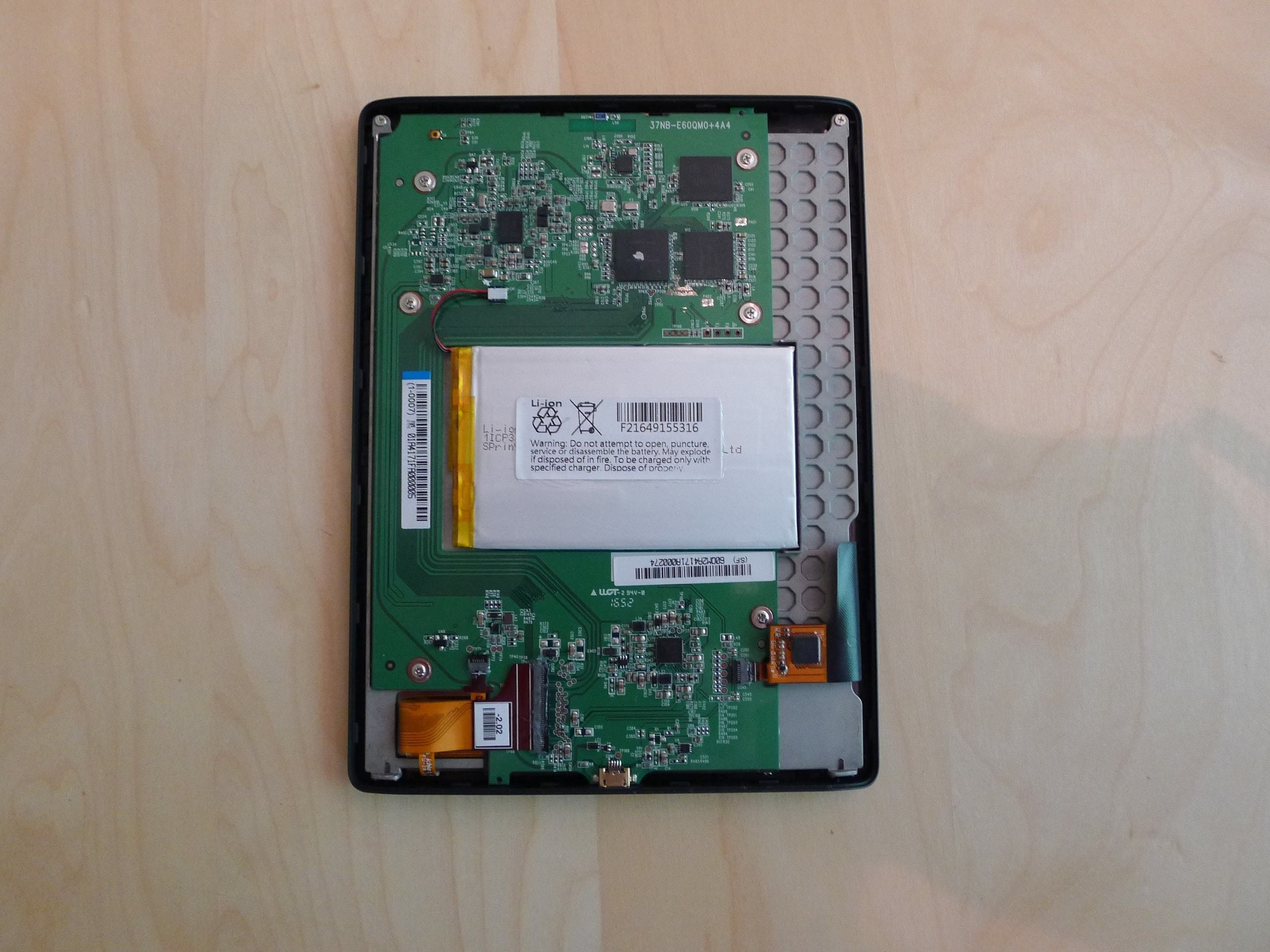

I've stupidly managed to break my H2O Edition 2 screen but resting my elbow on it after making the bed. I landed on it and heard a sharp crack. The screen now has 2 horizontal and 2 vertical lines running through it. The comfortlight still turns on when the power button is pressed and turns off when the power button is held.
I've done my best to research this issue but there doesn't appear to be much info on how to repair the H2O Edition 2 on the net. I have a number of questions that will let me know whether to proceed in trying to repair it over purchasing a Clara HD instead.
1. It appears I have broken the glass substrate - if I simply replace the screen will it work again or is the touch mechanism broken?
2. The device was second-hand and had a deep scratch in the screen - will the new screen be scratch-free or merely sit below the already scratched IR layer?
3. Does anyone know the screw type holding the back cover on? I am assuming it's a Torx screw but unsure which screwdriver to purchase.
4. Does it use the same screen as the H2O v1 and can this be purchased on AliExpress?
5. Does it require melting the adhesive off of the bezel like on Edition 1 or is it constructed differently?

screw in picture looks like torx to me
display type should be on the cable (-2.02 + barcode in picture), but display type is printed on the backside, so you have to lift the latch on the connector and take the cable out to see
we just had another display repair thread https://www.mobileread.com/forums/sh...d.php?t=316058
not your device, but maybe some generic advice
good luck
PS: an elbow can break more than just the display, try to confirm that the device still runs fine otherwise (like does LED blink as it should when you reboot or whatever)
PPS: I see this has one more cable than H2O, maybe the touchscreen...? no idea if this is one unit with the display or separate.

Ok I’ve acquired some tools and removed the case. Screw size is Torx T5. The screen model is ED068TH1.
drbroom is offline   Reply With Quote

Update 2: I've given up and binned the entire thing. Removing the bezel was easy as it's held in place by a square of light adhesive strips.
I was able to remove the motherboard from the backplate but was unable to separate the glass-substrate/screen/leds. The adhesive was incredibly strong, even after heat was applied via hairdryer. I tried prying the glass substrate off of the metal backplate but ended up crumbling the glass and shaving off my plastic spudger. I even tried in-between what I assume was the light-guides and the e-ink screen itself but it was too tightly adhered.
This, in conjunction with not being able to find a place to purchase the panel online, meant it went in the bin.
I've just purchased a brand new Clara HD.
