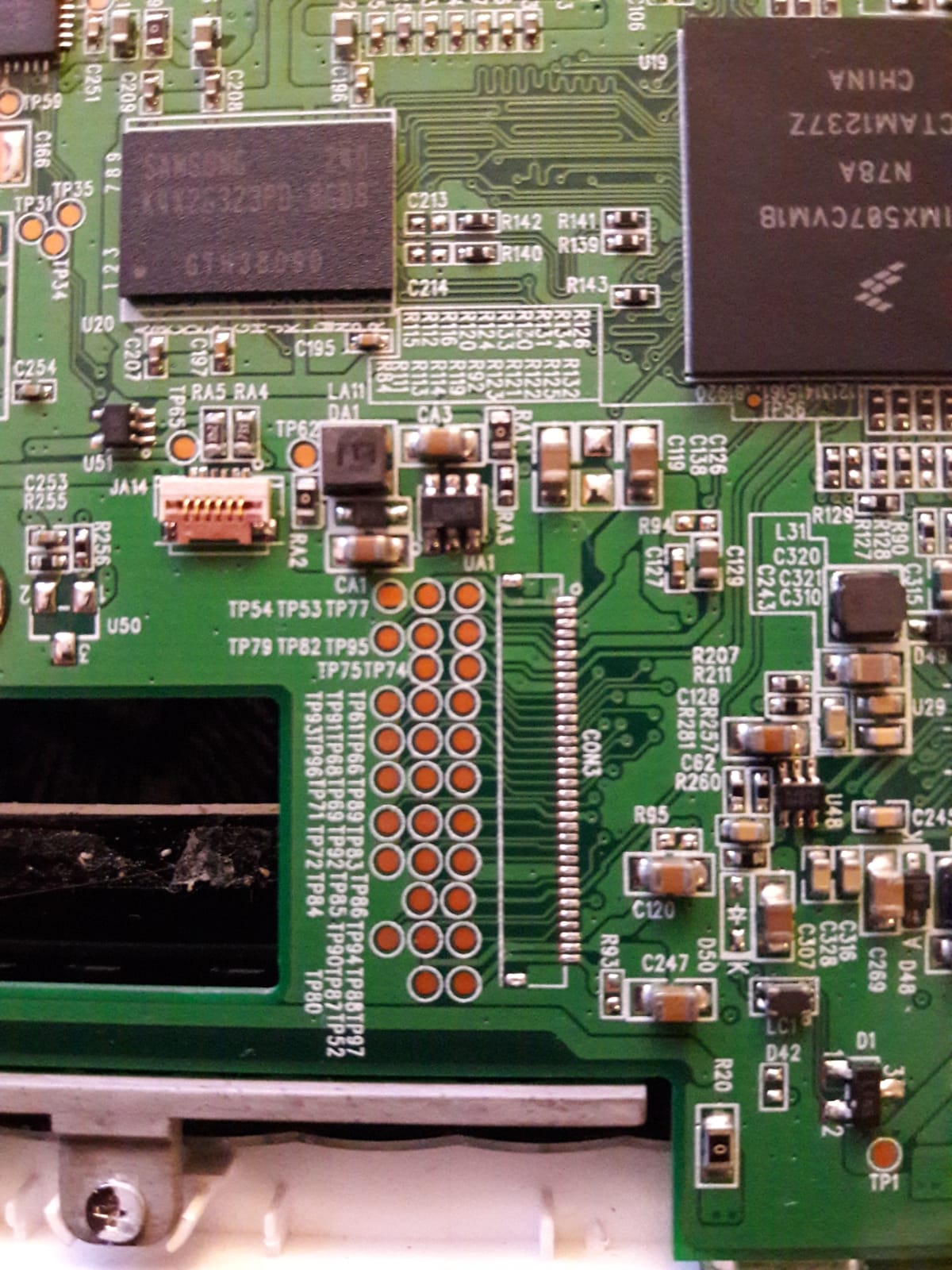

Hi everyone!
I came across this forum as I seem to have (extra-ly) broken my already broken Kobo Glo, and you guys seem to be quite knowledgable. So I figured, if there is any way to fix it, you would know!
While I was trying to replace the broken screen, I seem to have broken something off of the back of the motherboard (?), see the picture attached (yeah, I'm an idiot, I know ).
Is there anyway to fix this, or is the e-reader lost forever?
Thanks in advance!
Stephanie

do you have a better picture?
these flex cable connectors have latches on them to hold the cable in place
if you break the latch you might be able to do something else to hold the cable down
if you break the connector itself then poo.
well a new one could be soldered but that's not something you casually do at home

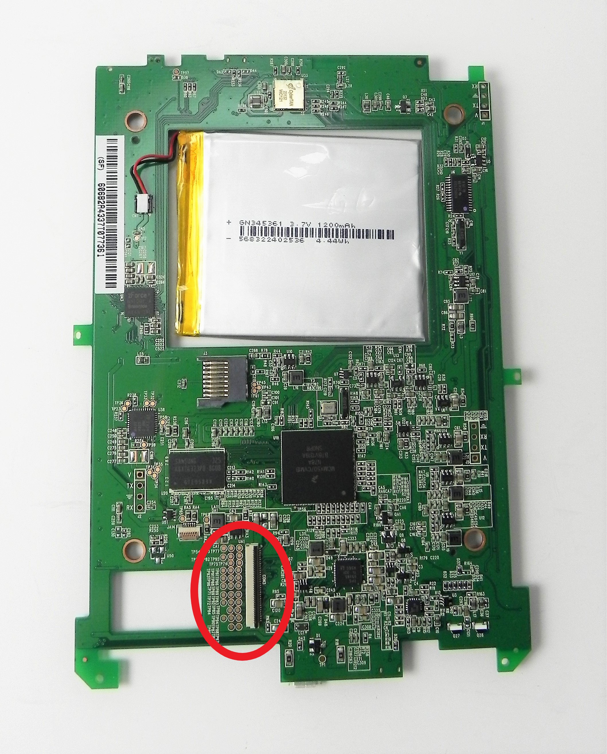

So I broke the whole thing off (go big or go home right? )
I do know someone who can solder, so that might be an option. But I would need to get a new connector. Is that possible to find?
(I attached another picture, hope this one is clear enough)
(Also just noticed that the topic says HD, but it's just a normal Kobo Glo)

no idea how you manage to do that
you can get these on aliexpress, just which one (many different types)
with some luck there is a type number on the connector itself
otherwise you have to count pins and measure it...
how to solder https://www.youtube.com/watch?v=CVPEHgfeoGE
your case more difficult since other components right next to it
good luck
