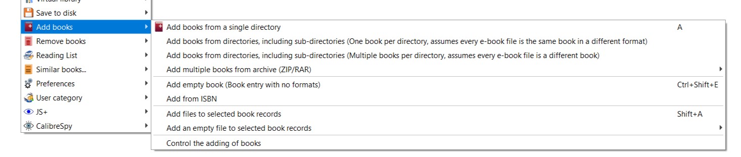

You can add books from various directory structures, viz
if you use toolbar buttons the Add Books flyout menu is a drop down menu
But you must decide if you will extract metadata from file names using a template, or from the metadata embedded in the ebook file content. You set that in the Control the adding of books->Reading metadata tab.

Many thanks for the swift, helpful response.
The problem is that I couldn''t see the dropdown menu you posted....
after a search I found it from a small down arrow on 'Add Books' - something I had simply not noticed
I will give it a good try.
ANd thank you for the kind help. Much appreciated.
