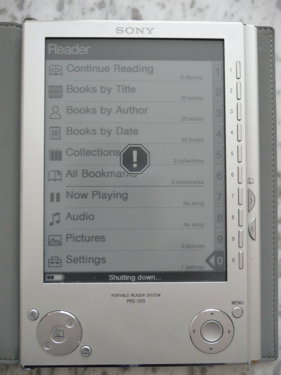

Last night I tried to shut down the reader, as I do every day, but it hanged. This is the screen I still have, 14 hours later:
I've tried to soft reset and to hard reset, but i've no response.
Can you help me?
Thanks.

Soft reset doesn't "do" anything other than power down the machine - the image will still stay there on the screen (remember that eInk screens preserve their image without power). Have you tried switching it on again after you've reset it?

Yes, I've tried, but there's no change in the screen. May be the battery is discharged? Now I'm charging it, and as soon as it finish i'll try again.
Thanks for your quick answer

Definitely sounds like a flat battery in that case! Note that if the battery gets too flat it can be "problematic" to charge using USB. If it won't charge, go to your nearest video game store and buy a charge for a Sony "PlayStation Portable". It's the same charger spec as the Reader, and will charge it for sure.

The screen displays USB icon and led lights in red. I've unplugged the reader and switched it on. Works fine. I will complete the charging.
In the first moments of panic, I had read https://www.mobileread.com/forums/showthread.php?t=21337, but I believed that first point didn't suit this scenario. So, my apologies to Patricia, and my thanks to her and HarryT.
