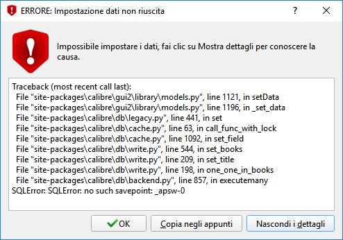

Hello,
for some time I have received the same error twice, does anyone know what it is due to? can you correct?
The error in Figure 1 appeared when I tried to change the name of the book, the number 2 when I tried to delete it, but I think it's still the same.
Thanks,
Gianni

this will happen if you put your calibre library in some unsuitable location, such as a network drive, or a folder that is synced via a file sync tool such as dropbox. Or alternatively your antivirus could be interfering, in which case try excluding the calibre library folder from it.

I receive this error every time my library reaches approximately 50,500 books. I have excluded the library from my anti virus. The number of books seems to be an issue. Is there a way to expand the size of the library?

Have you run Library Maintenance? That cleans metadata.db of dead records (records are normally just marked as unused on most DB systems).
If your DB has grown, it may exceed the file system (formatted type) allowed size.
What is the size of metadata.db?
What format type is used on your disk?
What OS and is it 64 bit?
Many folk have lots mor books.

Thank you for your response. I'll try out Library Maintenance. I have never used it. I am using Windows 10 64 bit. I don't have any comments or custom columns.
