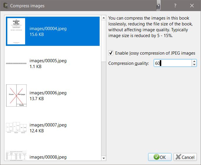

I may be missing something here. Why not use the super quick and effective tool provided by Calibre to reduce image file size?
In the Editor window, select Tools > Compress Images Losslessly. Checking the "Enable lossy compression" option will reduce them further. I often use a compression quality value of 50.
Afaik, that only changes compression ratio, not resolution.
That tool also allows you to Resize eg 2048w > 450w (and maintain aspect)

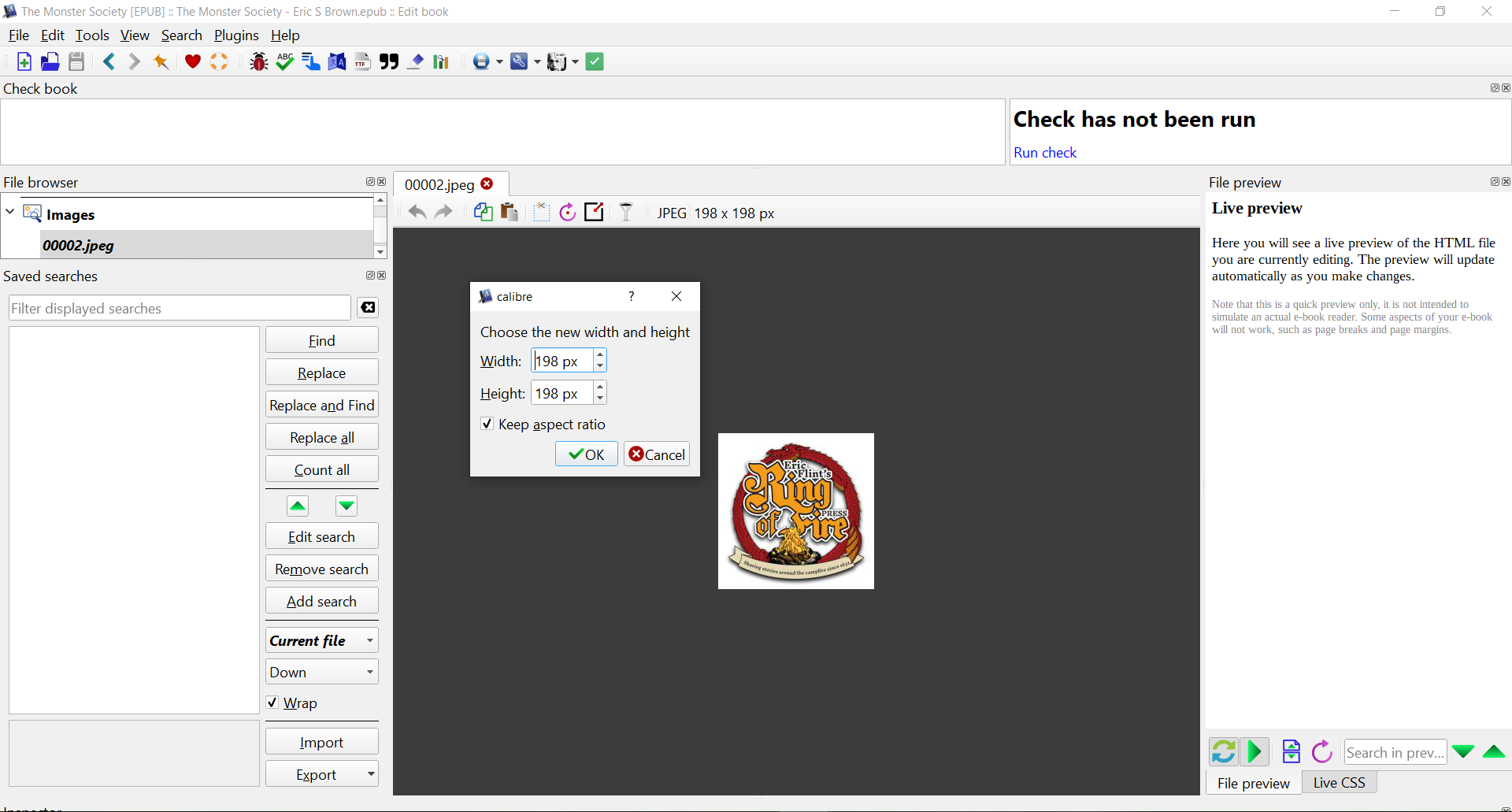

Curious, aside from conversion, how do you change resolution of images inside a book using Calibre (not just cover but other embedded images as well)?
There's only so much that changing compression ratio will do. I have books with 12 megapixel images. For books I deem unreasonably large, I unpack, then use IrfanView to batch resize and convert, overwriting in place (JPEG compression 75%), then repack.
Open the book in calibre's editor, select the image and edit away. See attached screenshot.
Yep
That was what I use frequently
Thanks for the tip. I was looking for an option in the menubar.
Just tried it and I think I'll stick to my current method. File manager + IrfanView is easier when I need to preview and process a batch of images.

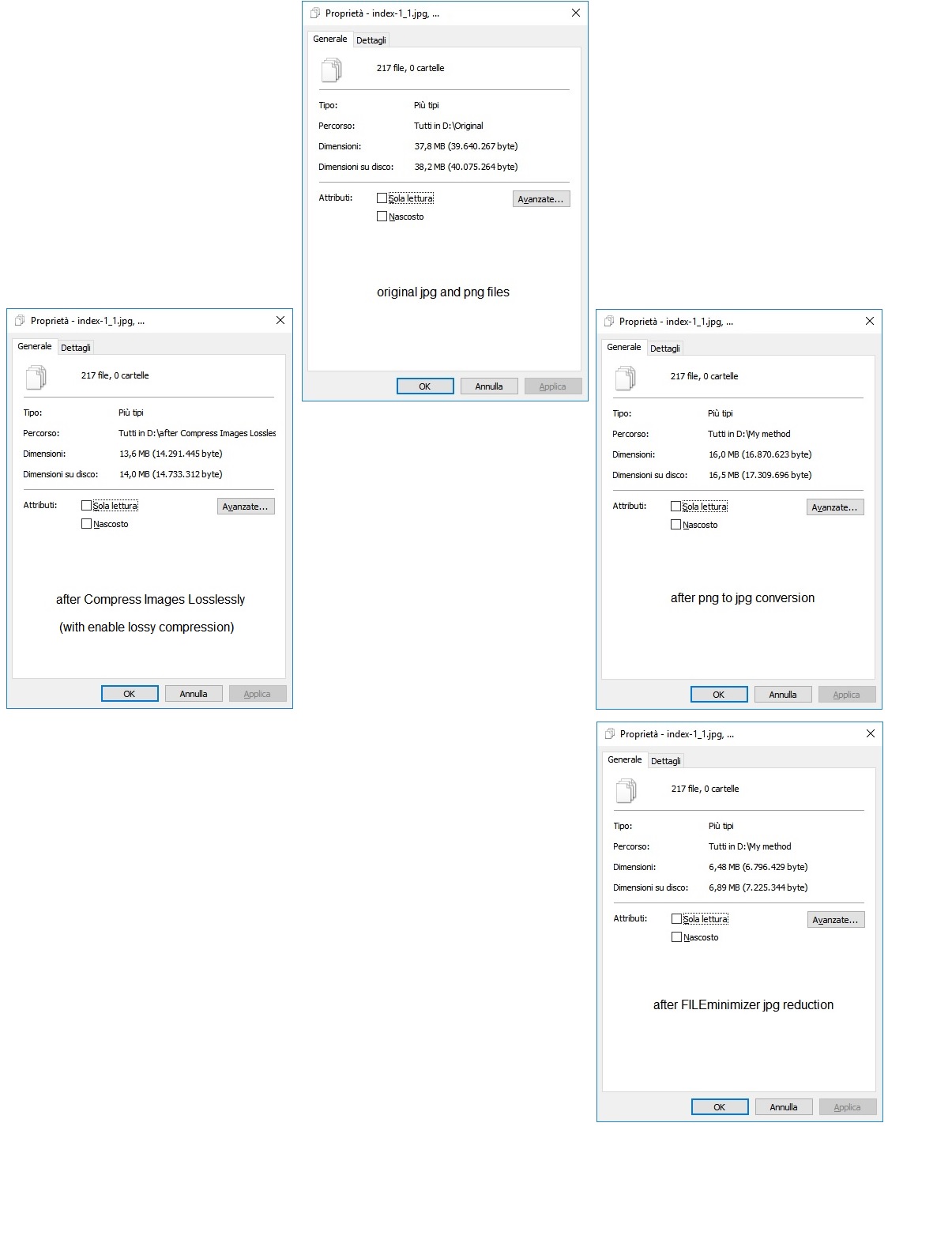

Only to have complete information
Hi,
In the included image there is a comparison between the two image compression methods: Compress Images Losslessly and the one I use.
Bye,
Gianni
