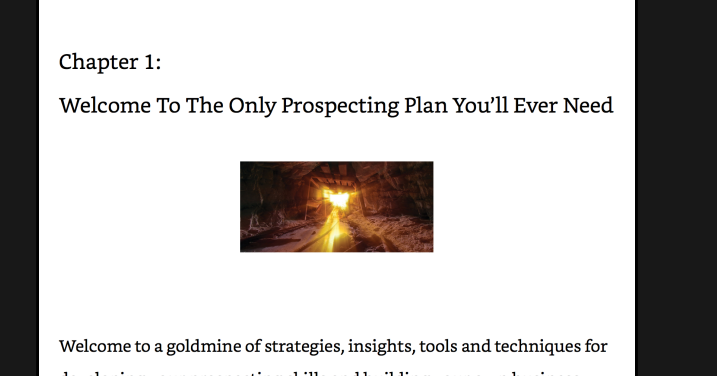

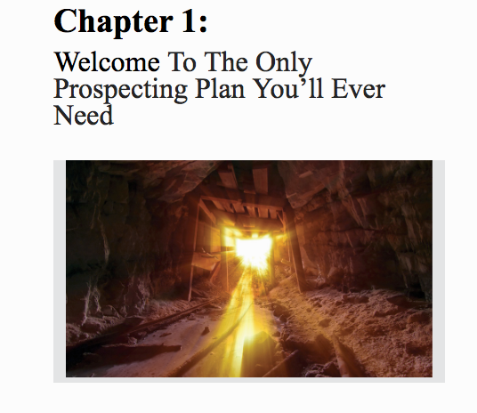

Correcting image sizes from Sigil to Kindle Previewer
I have a large project which was originally done in InDesign. I needed to create a reflowable .mobi file. After realizing doing this thru InDesign there were too many nested images to deal with so I just exported an HTML file from InDesign and did the formatting in Jutoh.
Jutoh did a great job re nesting the images but I did have to correct alot of styling which exported incorrectly but overall I was pretty satisfied.
Now came the bad part as converting the html to an epub using Sigil generated alot of errors I was able to correct and get an errorless epub that looked pretty good but the final file the client wanted was a mobi so I opened in Calibre and converted the epub over to a mobi.
The result is the images are crushed to a point where they are almost 1/2 of what they looked like in the epub so what I'm asking is whats the best way to get the images as close in size as the epub in this mobi file?
see images in attached files.
thx R

Since you are doing the conversion with Calibre, you might want to ask that question in their forum. Especially since Calibre has a large number of conversion options that may or may not be in play when converting to mobi.

Or try with Kindle Previewer to do the conversion straight from the epub. Also do you want an old style .mobi or a .azw3 (more like an epub but still reflowable)?

@ralphiedee...
"...so what I'm asking is whats the best way to get the images as close in size as the epub in this mobi file?"
This is a well known problem in Kindle mobi files where image dimensions are altered at random for all images that are smaller than max page/screen size.
Here are some practical ways to resolve this problem. You could manually code each image in the epub as a percentage of current device screen width -- example shown below:
<p class="centered"><img alt=" " src="../Images/Your_Image.jpeg" style="width: 40%;height: auto;"/></p>
Or you could use Sigil's CustomCleanerPlus plugin and just select the "Reformat smaller images..." option which will automatically convert all image formatting in the epub to percentage format values(as shown above). After conversion, you should be able to further fine tune individual image size by altering the "width" value as needed in the epub.

Hmm, alot to report back here. Original post was about getting images to be the same size dimensions as the epub file as exporting thru Calibre to a mobi gave me tiny images. So I did as suggested and coded each image as percentage inside Sigil and made the new Kindle previewer convert the epub to the mobi file and the images look fine. But then I decided to convert the epub to mobi in Calibre and it crushed the images back to where I was before.
All of this is for a client of mine and having gotten so sidetracked I also realized that the file size was 127mb. Way too big to upload to KDP anyway.
Not gonna lose sleep over this as this book is 700 pages, but I learn something everyday.
