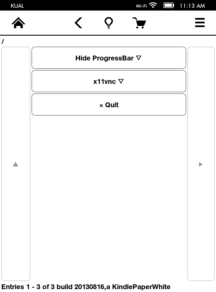

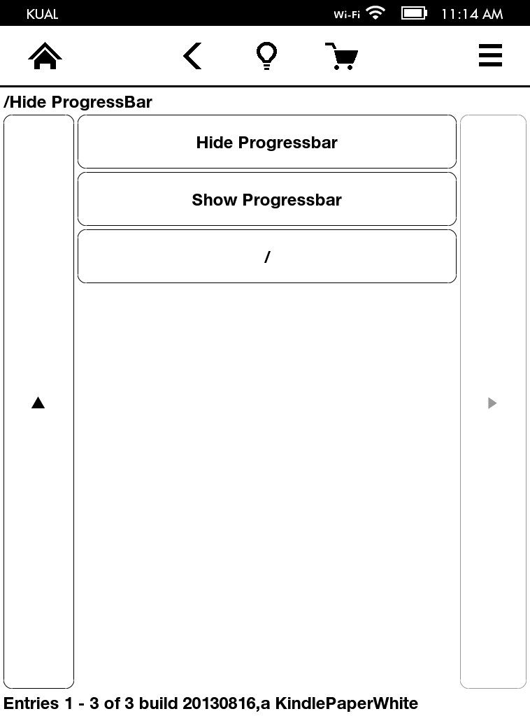

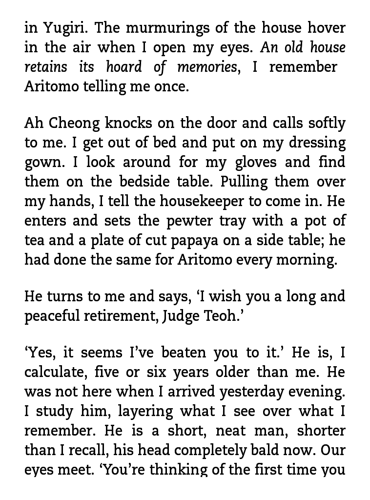

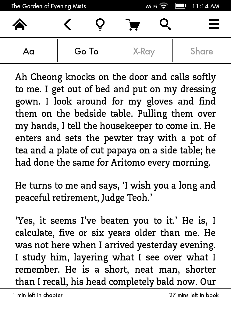

Hide Progress Bar on Kindle Paperwhite
Here is a Kual extension to remove progress bar on Kindle PW 1 which is quite easy to adapt for other Kindles also.
It is not a perfect solution, basically what it does is to draw white rectangle over progress bar, but still works.
[moderator deleted attachment - please see below]
How to install:
1. You need to install Kual
https://www.mobileread.com/forums/sho...d.php?t=203326
2. Extract the content of the zip into extensions folder on Kindle's main directory.

Unfortunately attached version does not work on Kindle PW (v. 5.3.4).
sinan is offline   Reply With Quote
Old 11-04-2013, 04:19 PM   #5
twobob
( ͡° ͜ʖ ͡°){ʇlnɐɟ ƃǝs}Tır
twobob's Avatar
Posts: 6,586
Karma: 6299993
Join Date: Jun 2012
err yeah. There was an error.
it's PageTurnAction not PageAction on a PW. fixed it now. check the script in the version you have:
(tested now on 5.3.6)
