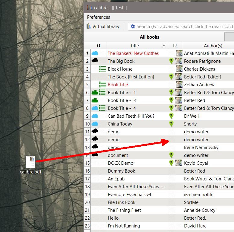

Also try downloading this file https://manual.calibre-ebook.com/calibre.pdf to your desktop, then drag and drop it into the calibre book list, viz:

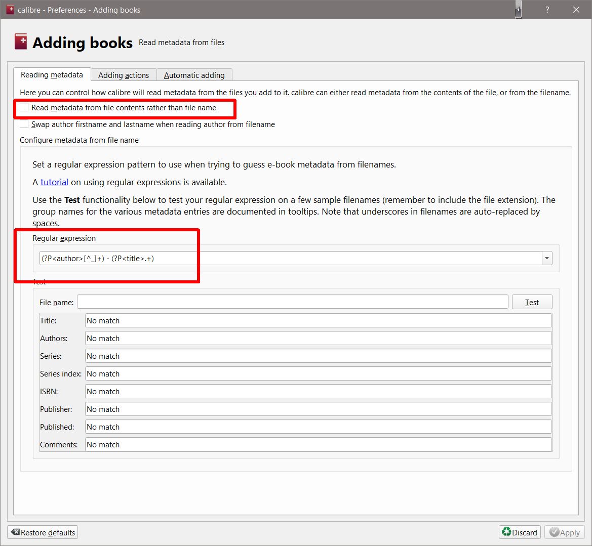

And - what do you have in Preferences>Add Books>Reading Metadata - in particular the settings I've highlighted below:
