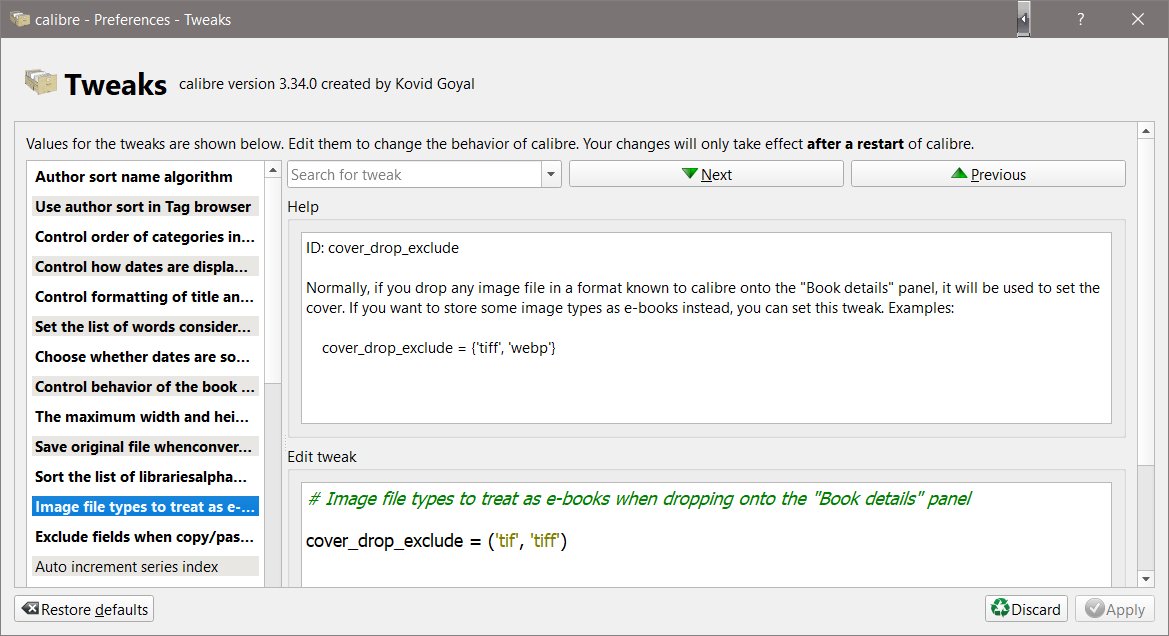

If I have more than one alternative cover (or any other images) I want to keep for a book, I put them in a multi-image TIF and drop that on the book details panel. This requires the following tweak:
