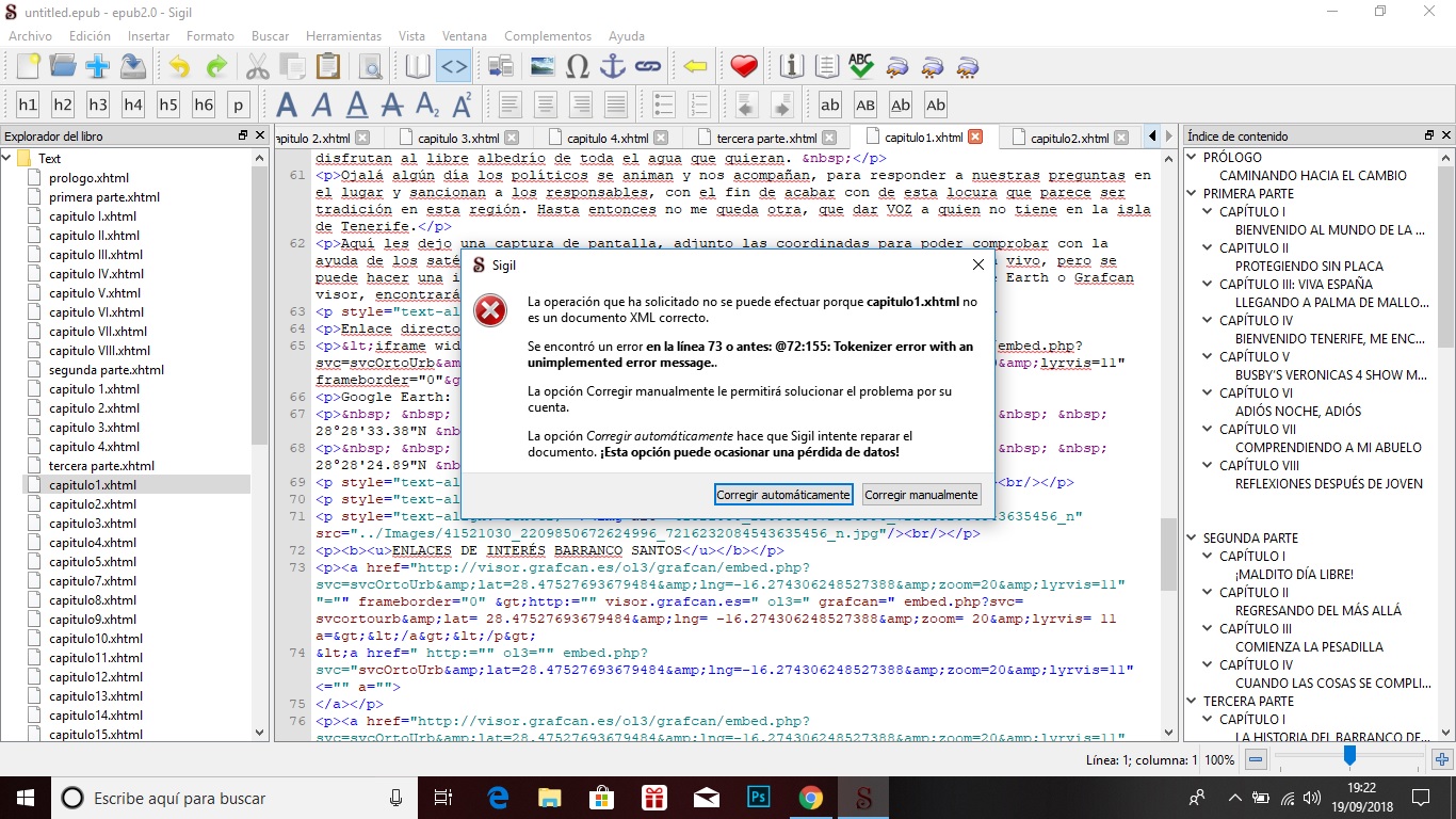

I can not put this chapter in read view. He does not let me do anything. As much as you put "automatic" it keeps giving error.
I've saved the entire Epub to check and no link is seen in the Epub.
thank you very much

Look at the end of line 73 all those entities don't belong, they should be (closing) TAGS
Somewhere along the line, you got the tags out of balance and auto-fix got it wrong . It may have started out as simple as the order of the closing tag was place after instead of before (you closed an outer tag before the inner tag)
Nest order is very important (a good reason to keep your code 'pretty' )

@jenni fuentes: Your <a> tags with website links have the wrong attributes.
Double-check all <a> tags and make sure that they only have an href attribute. For example:
<a href="https://www.mobileread.com">MobileRead</a>

thank you, thank you so much, really!! already solved!!
without you, I would not have managed to fix it.
