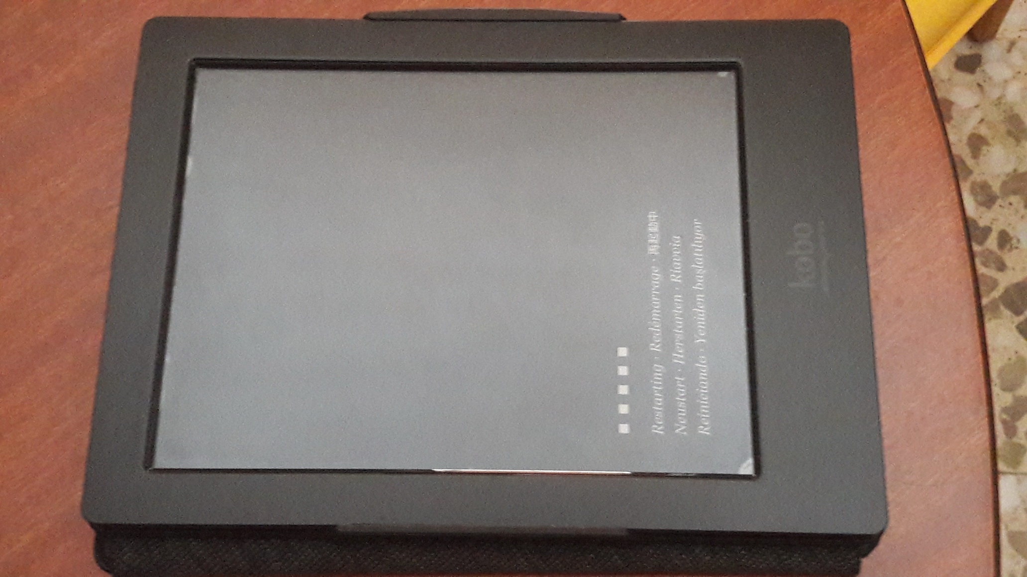

I need some help with my H2O.
I installed a fw package (fyi 4.8.11073) but something weird occurred and seems that the file was corrupted before transferring to device. The corrupted part of archive affected the complete upgrade directory (u-boot and uImage files).
The device did the update and it stopped in the restarting screen. The light stay off and when I try to switch on (always with the restarting screen present) the light of the button stay on during 10 seconds but nothing happend.
I have tried to reset with the pinhole (push during more than 10s and 30s) and nothing, and the special reset with start button pressed and touching both lower squares (I have some practice with it).
Have someone any idea to restore it (without open device)?

If the computer detects it, there may still be some hope. If you could get me a screenshot, I'll have a look. I don't know of any guide to open the h2o up though.
If you still have warranty, you may want to see if you can get it replaced.

Here is the screenshot. The screen never change even connected with PC.

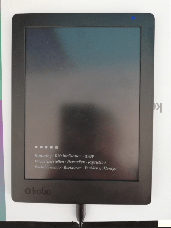

Thanks to all people for reading in advance.[/QUOTE]
Hi !
I have the same problem.
1) Connect KOBO to your PC.
2) Press the "POWER button" until the tablet turns off completely and again continue to "!hold!" POWER (10-20s).
3) As follows, the recovery screen and your tablets will be restarted to (rescue system) firmware '4.6'.
Good Luck

That's the factory reset, which he said he tried.

Thanks for the idea, but your H2O is Edition 2 and mine is the first. In any case I have tried the method and no luck.
Like geek1011 said, this is the factory reset for the new H2O. For first version it's different (described in first post)
