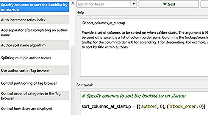

Here is a screenshot of my Tweaks tab that shows the sort order:

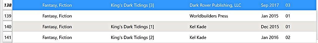

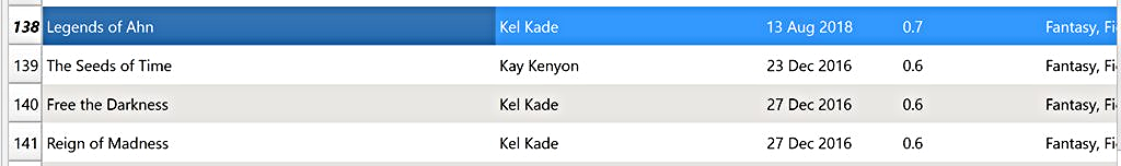

Here are screenshots where it's obviously not being sorted by Author for just this one book.
Any thoughts or suggestions on what could be causing this? I've tried copying the Author name from one of the properly sorted books and pasting it in the book that's out of order, but this doesn't resolve the issue. And as I said earlier, this sort issue carries over into Calibre Companion for Android.

@IFireflyl it would help if the images showed the column headers, and if you told us how the custom column is defined.
Authors are sorted on the author_sort value - check any anomalies in Metadata Edit or in Manage Authors

To all of you, I appreciate all of your help. It was the Author Sort. Manage Authors had the Author Sort and the Author set to the same thing (I prefer to have my authors listed by First and Last Name). I just assumed that all of my ebooks that I added would have the Author Sort be correct. I was mistaken. I fixed the Author Sort and my books are now completely in order.
