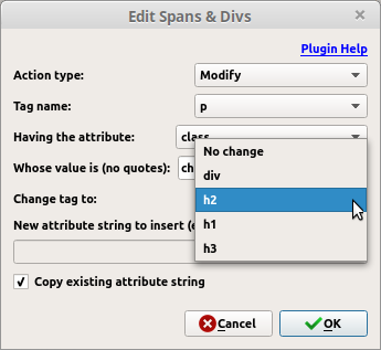

I highly recommend you install Diaps Editing Toolbag plugin, will do a lot of what you want.
bernie
Name:	Screenshot from 2018-08-12 10-28-25.png
bernie
Thanks for the suggestion. I looked that up and installed it just now. I saw the tool... but honestly it looks like that tool might be more complicated for me now. Now that I've figured out how to "group" and refer to the groups in the replace box, that is. The tool seems like it would change too much of the book formatting, *unless* I specified it pretty closely. But now that I know how the regex grouping works, it seems like specifying pretty closely that way is easier/more clear to me than it would be to use those tools. Anyway, I do appreciate the suggestion though!
