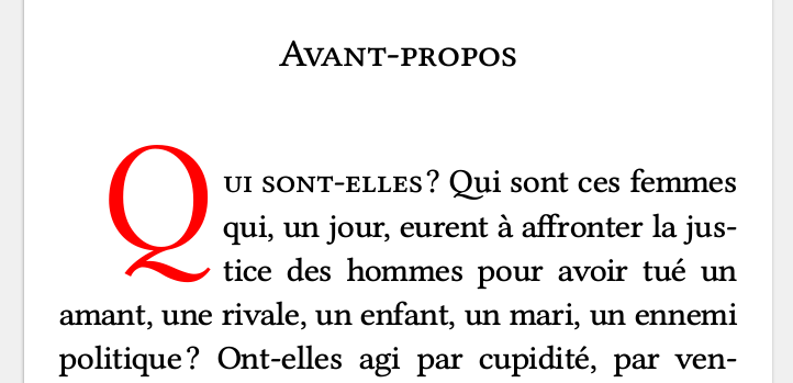

Here are the two regex I use in .json format (Calibre editor)
ugly
Now you can judge from the following screenshots, one example with a drop-cap on two lines, a second with a three-lines drop-cap.
ID:	164021   Click image for larger version
