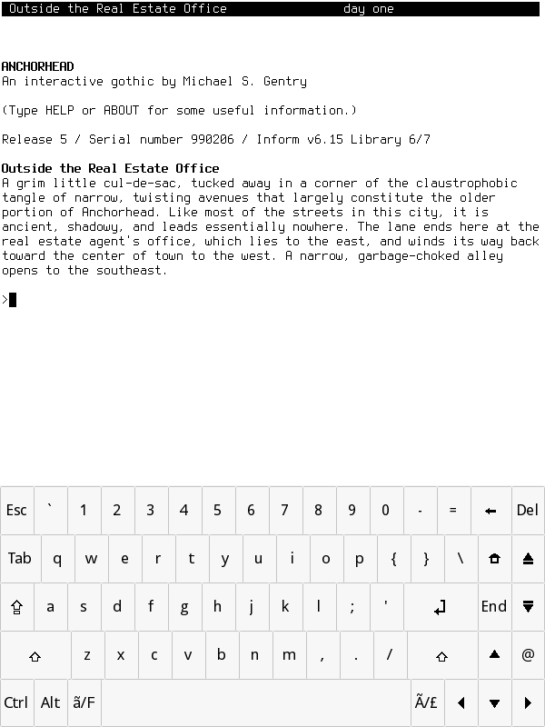

ID:	89697 Click image for larger version

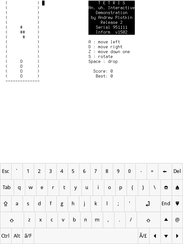

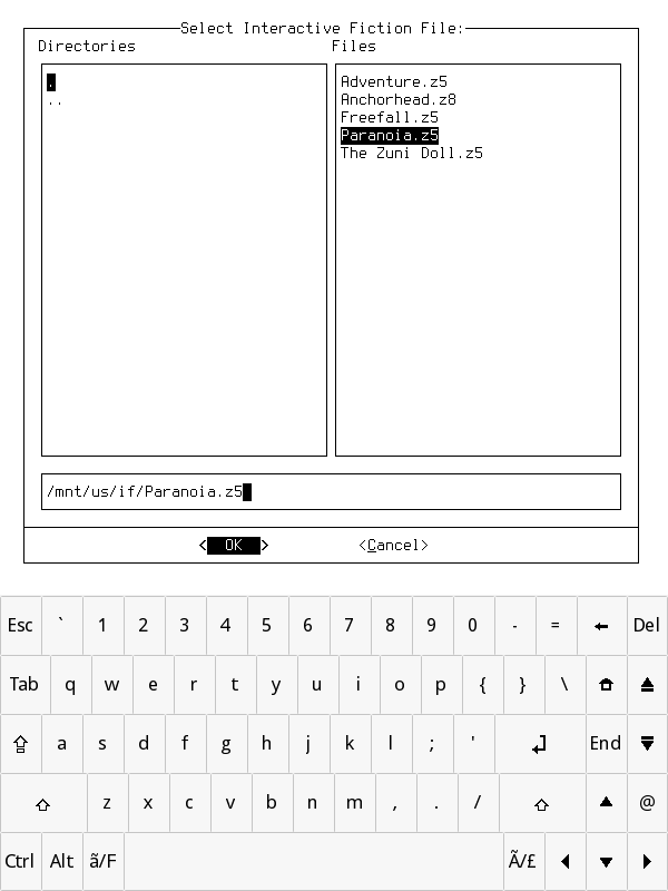

KINDLE UNIFIED APPLICATIONS LAUNCHER EXTENSION:
Also included are files so you can use it with the Kindle Unified Applications Launcher (KUAL, see below). It will add a "Start Frotz" option that includes a file selector dialog. This is optional, but without it you'll have to start kterm then type stuff to start frotz.
To use the Launcher extension, you will also need the separate "dialog" program installed (see below). I'm distributing it separately since it has general-purpose uses so someone might want just it and I don't want to maintain multiple copies.

I updated this with a GUI Launcher extension. Because you need to select which game to play, I needed a file selector, so I also ported dialog. It's attached separately in case anyone wants to use it for something else.
I altered the behavior of dialog's file selector to make it easier to use on a touch screen -- you just tap the desired file then tap OK instead of having to use the space key. Otherwise it's the same as the stock version.
I don't know if I like how it looks, but it works.
