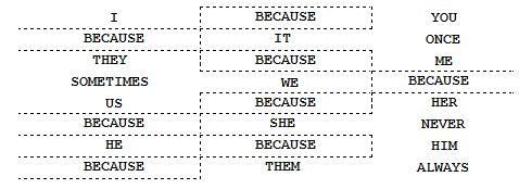

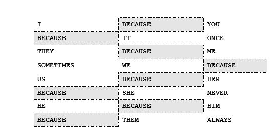

Take a look at the attached screenshots. In the first (MsW) cells are shaded, and in the second (Calibre converted) they are unshaded.
ID:	163557   Click image for larger version

Then presumably you are using something other than background color to achieve that shading.

As shown in the example, this is controlled by MsWord Borders & Shading for cells in a table. In this case, the shading was set at 10%. Since Calibre picks up the border setting(s), why not the shading?

Because there is no equivalent to shading in CSS.
