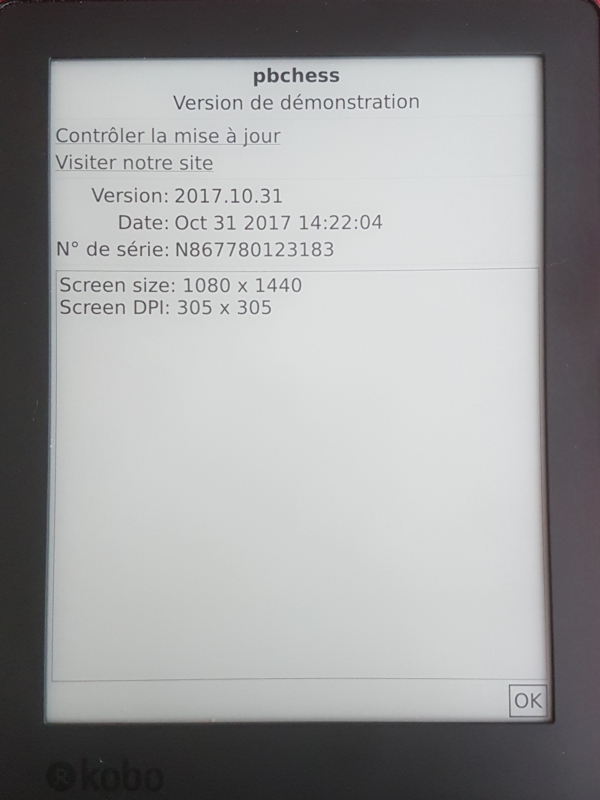

Pbchess that works perfectly displays 305 dpi on the same device, as the screenshot :

Is there a way to make a mistake on the screen resolution, as big as the official Kobo website that displays 265 dpi ???

https://www.sven.de/dpi/ count 265 dpi too.
It seems to be the right value
