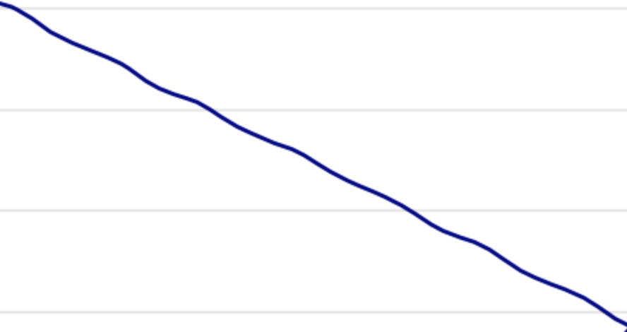

On my new RP1, lines don't seem to be straight. Drawn with a ruler, I get strange
wriggles. Even in the calibration page, when I draw the X, I get strange wriggles, so it is hard to calibrate. Is it just mine? Should I return it?
Below you can see my lines. All drawn with a ruler on screen (zoomed in... click for full page)
Actually, in this video you can see the problem a bit when the X is drawn. Mine is a bit worse, because the wriggle is in the middle of the X, not the edge:
https://youtu.be/ULCjmqKa5YU?t=5m36s

My feeling is that it is an anti-aliasing algorithm gone wrong. The waviness seems to depend on the angle and is very regular foreach angle. Could it be that the resolution of the pen is lower than that of the screen, and Sony is trying to make up for that?

Sony support said it is a problem with the pen, and they will send me a replacement pen.

I'm not sure what solved the problem. Amazon actually sent me a replacement tablet. I tried all combinations of pen x tablet but couldn't see much difference, and now the problem is almost gone. (I kept my old tablet with the new pen).
