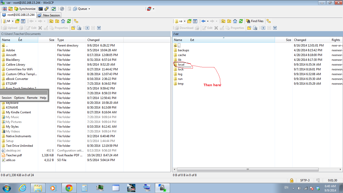

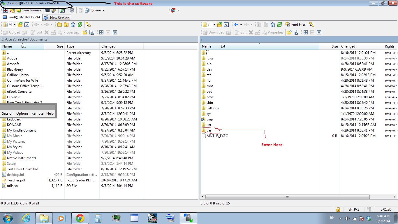

Thanks , Here is what to do :
I have put the steps in the screen shots.
ID:	128094   Click image for larger version
ID:	128095   Click image for larger version
ID:	128096   Click image for larger version
