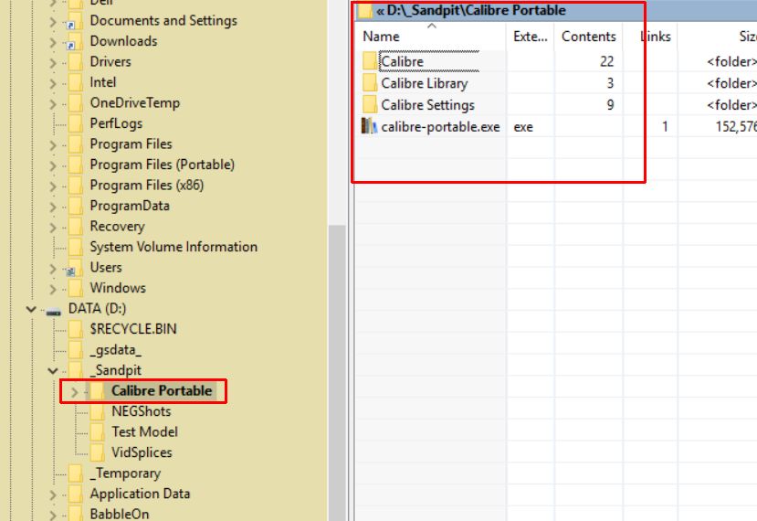

Minor point - portable installer creates a folder named "Calibre Portable" in the selected location - note the space between 'Calibre' and 'Portable' - viz:
Try using the built-in file dialogues - see CALIBRE_NO_NATIVE_FILEDIALOGS in ==>> Environment variables

I'm not clear by what you said about "portable installer creates a folder named "Calibre Portable" in the selected location."
The portable app is asking for the location and setting the Enviro Var did not change that (Unless my Value set as TRUE should be something else).
I also did try to choose a new folder which I named "Calibre Portable" using a space, again with the same result.
Sorry for maybe not grasping your instructions fully.
In your example, it seems that you created a directory of your choice, ie, _Sandpit to locate the Calibre Portable folder. So, in my case, other than letting Calibre take over the folder assignment by using the Envir Var (which I may have not done correctly), I'm not clear on how to proceed or why the problem is happening.
