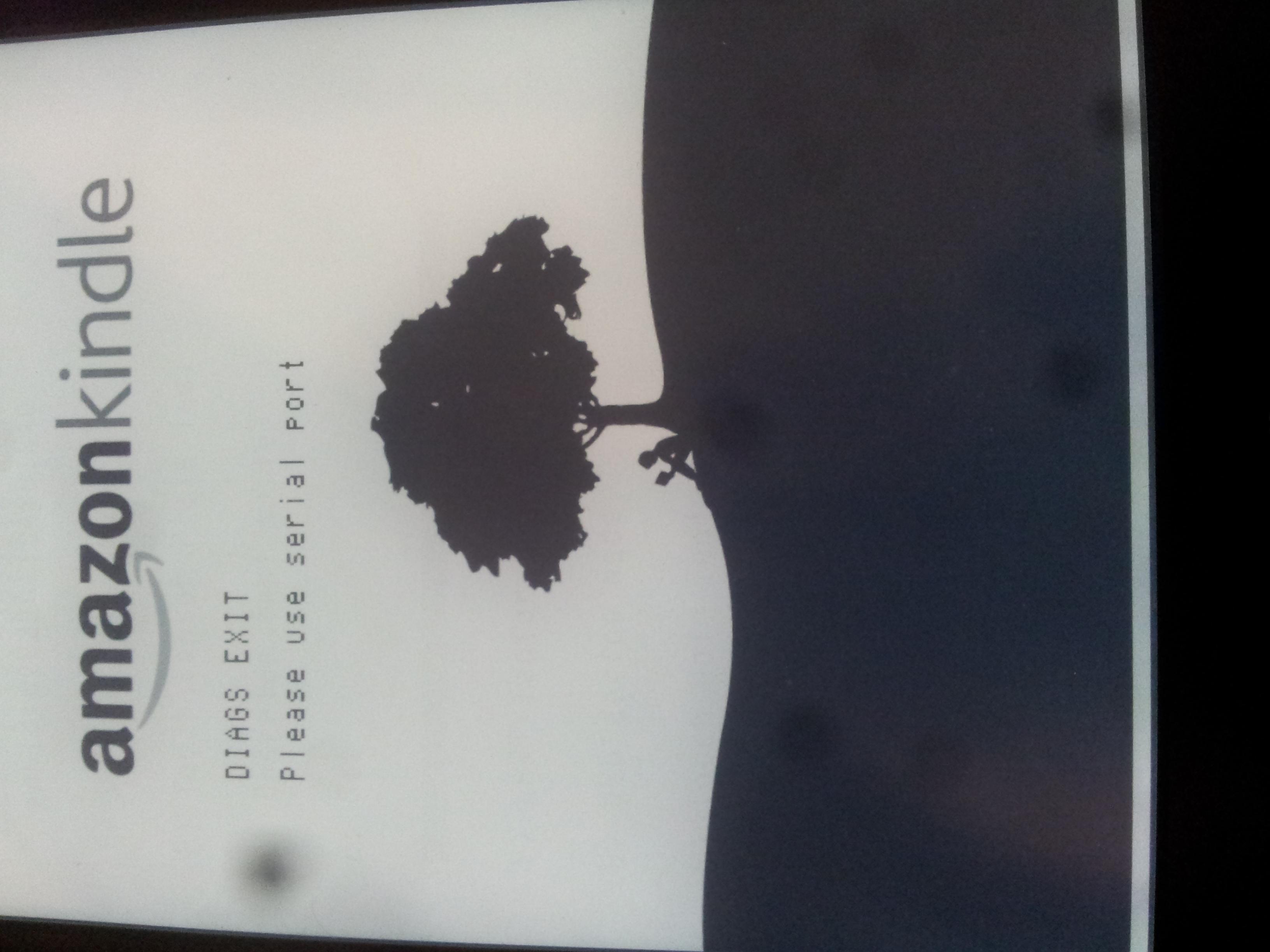

Hi,
I'm so sorry if I'm posting something already answered. I did a lot of research on this matter here and can't find anything that applies to this case.
I did something wrong (diags mode, install fastboot bundle - my bad I didn't read the docs carefully) and now my PW2 is stuck in the screen which one can see at the attached screenshot. The docs says somewhere that touchscreen doesn't work in fastboot mode on Kindle PW/PW2, so I can't either leave the screen, nor reboot.
When I hit power button, nothing happens. If I hold it pressed, the bottom power led starts flashing orange on about 10 seconds then, at about 15 seconds, the backlit flashes twice but the screen itself is not refreshed. And that's it. Nothing happens anymore, no matter how long I keep the power button pressed.
lsusb on Linux reads only after 15sec power pressed:
Bus 001 Device 031: ID 1949:d0e0 Lab126, Inc.
I have no access to any of mass storage modes. Drivers from FastBoot GUI for windows doesn't work. SSH via usbnet is also unavailable. I have no know ways (to my knowledge) to access my PW2.
Did I brick my PW2 permanently or is there a way fix the mess I did?
I really appreciate any help in advance.
Follow the on-screen directions.
See the image that you attached above.
Old 01-21-2014, 02:43 AM   #4
As I said on the first post, touchscreen doesn't work when PW2 is in fastboot mode. So, one can't 'click' diags exit.
'Please use serial mode' is not an option too, because PW2's serial port, AFAIK, is inside the device and requires tear it down, which could potentially damage it, as well as also requires soldering skills (which I do have). More on this here and here.
Anyway, thanks for the tip.
If you rule out "Use serial port" - then your **ONLY** other option is to return it for exchange as "broke".
You don't have to tell them that you where the one that broke it.
And yes, we know about those links - we where the first to document that on the KPW2 right here.
