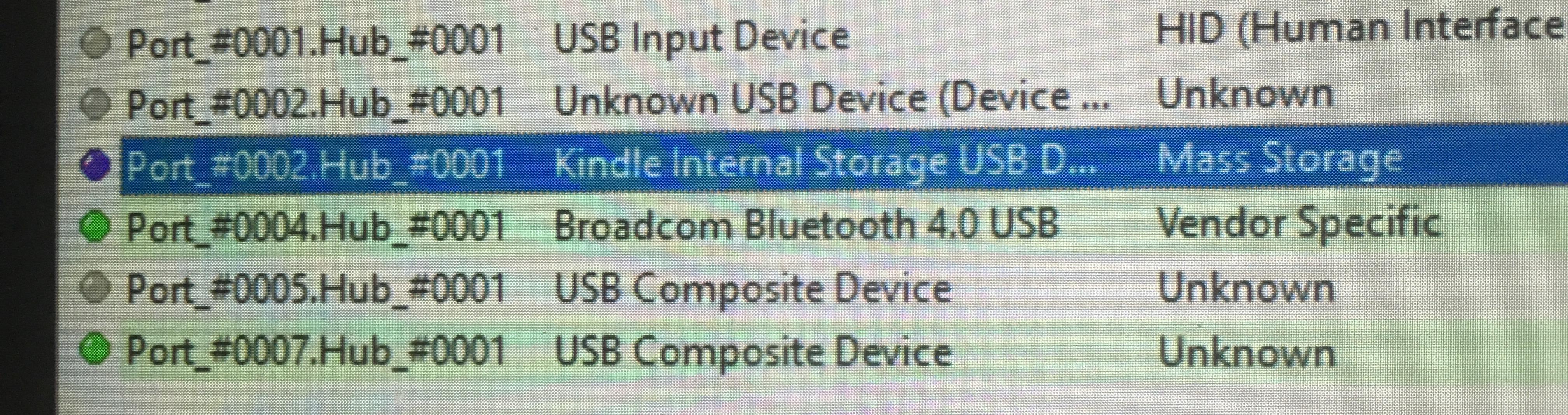

Can't upload a screenshot for whatever reason from my phone but I'm in the USBDeview screen looking at a bunch of device names. Kindle Internal Storage is one of them. I'll try on my laptop

Old 08-14-2017, 04:02 PM   #11
MagicDragon
MagicDragon began at the beginning.
Posts: 10
Join Date: Aug 2017
Was too big I suppose
MagicDragon is offline   Reply With Quote

the columns in that app I would like you to look at are labelled "Vendor ID" and "Product ID".
if it is like mine,with no battery it would be "1949" and "dead".

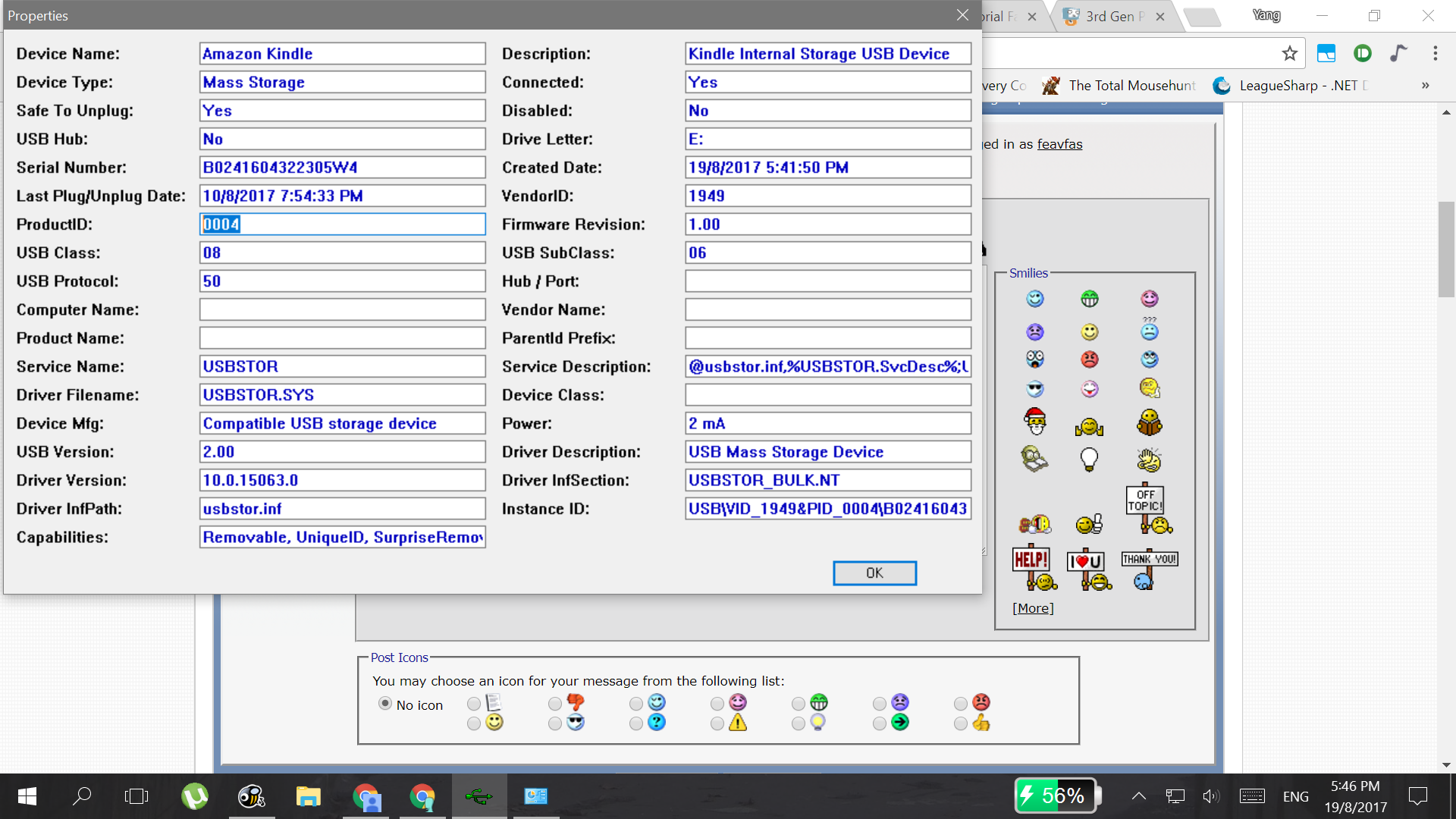

Old 08-19-2017, 05:49 AM   #14
feavfas
feavfas began at the beginning.
Posts: 5
Join Date: Aug 2017
Device: Kindle Paperwhite Gen 1
Sorry to hijack this thread, but I am facing a similar issue.
Attached is the screenshot from USBDeview, btw I am using Paperwhite Gen 1
