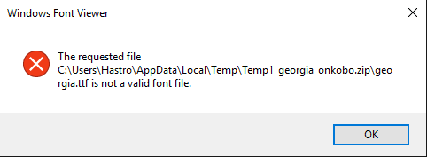

I find that kobo default font is Geogria. While this font is an incomplete font and does not yet support the language of my country.!
I have edited the Geogria font in FontLab Studio so that it can display my language. But do I realize that there is something that i can not open the font Geogria from kobo firmware on my computer and reverse?
Plz help!

I believe the fonts supplied as part of the Kobo firmware are encrypted. And replacing them needs an encrypted font. I don't think I've heard of this being broke. I can't remember, but there might be a patch to change the default font to something else.

You should be able to use your non-obfuscated font in KOReader. (An add-on reading program for a number of devices including Kobos)
