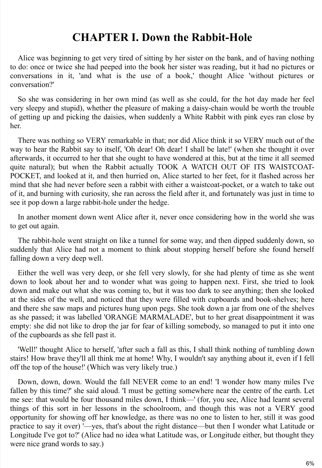

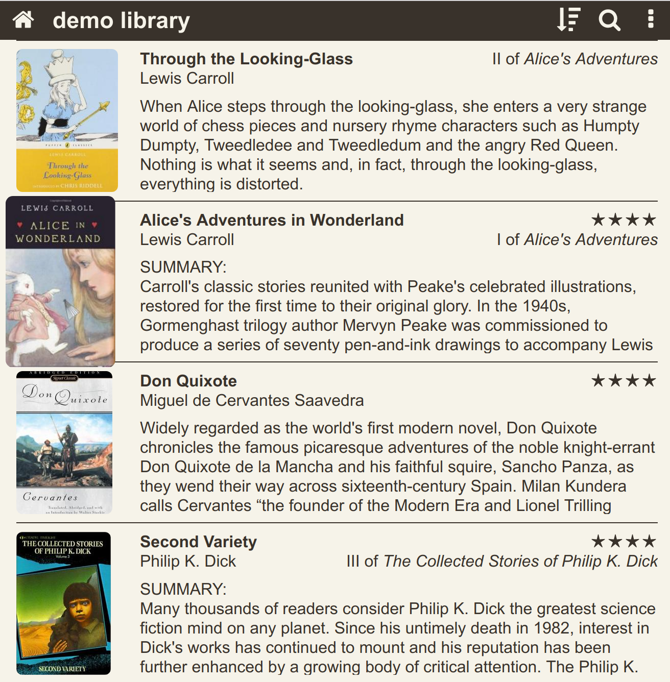

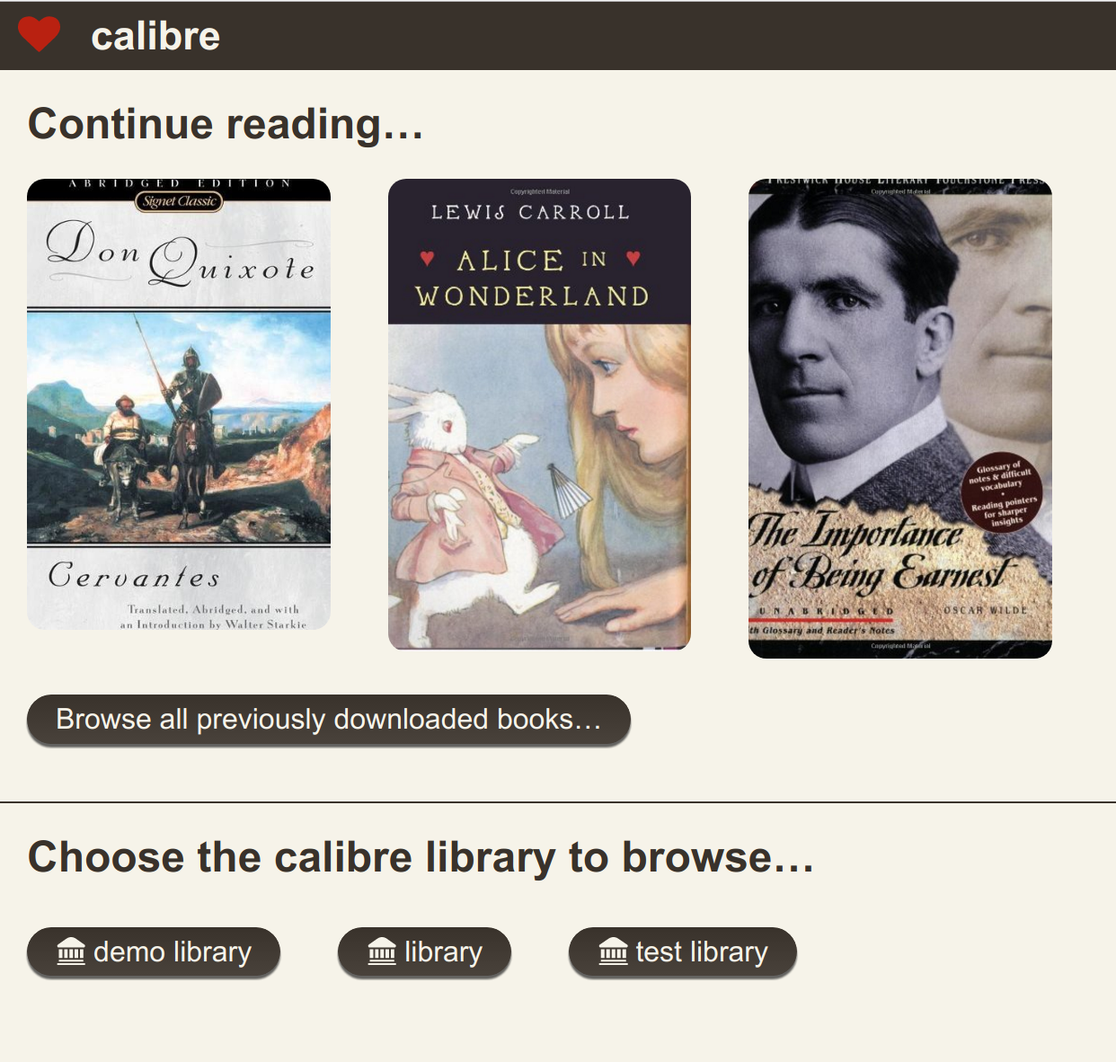

The major new features are:
  1. All new Content server.
    • You can now read books directly in a web browser, even when there is no internet connection. This means you no longer need to use an app on your phone/tablet to read books. Instead you can directly connect to the calibre server and read books in the browser itself. The books are stored in offline storage so you can read even when the network is not available.
    • The server can show multiple calibre libraries
    • The server supports multiple user accounts. And you can control which libraries each user can access.
    • The server can now make changes to your calibre libraries (adding books, editing metadta, etc.). Currently this feature can only be accessed using the calibredb command line tool. A web user interface for it will be added in the future.
    • The server is very new and will have many missing features. These will be added over the course of normal calibre development after calibre 3. Feel free to request new features as part of your beta feedback. A list of features I intend to add in the future is here: https://github.com/kovidgoyal/calibr...e/srv/TODO.rst

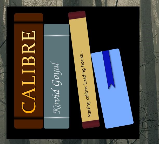

Installed Windows portable, welcome wizard did its normal thing, portable started, showed the splash, and hung - Windows reports program not responding, so I terminated it. Here's the splash
No other calibre was running - this was immediately after a WU reboot. My calibre 64 bit (2.84), and a previously installed calibre portable (2.83) are working fine.

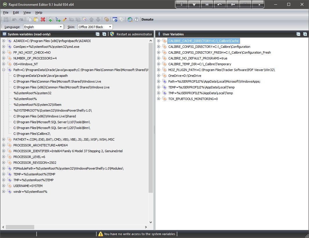

Old 05-10-2017, 06:56 AM   #13
Posts: 22,036
Karma: 30277960
@BR: calibre portable is 32bit.
And you can use whatever browser you like with the server.
If the issue, as others have reported is only with calibre-portable.exe, calibre-debug will not help.
It hangs forever, well 5 minutes, in the "Loading books" phase. CPU load is ~25%
I'm accustomed to startup times of < 20secs on a +100K book library.
I wonder if it has to do with existing environment variable settings, mine are:
Windows 10 64bit 1607, up to date as of 2 hours ago.
