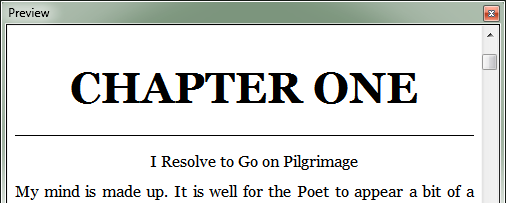

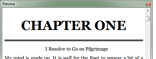

Try using <hr /> (horizontal rule) for simple straight lines.
You can style it in the CSS stylesheet to be any thickness you like, or a double line, etc, etc.
In the stylesheet, something like:
hr
{border-top: 1pt solid; margin-top: .5em; margin-bottom: .5em}
or
hr
{border-top: 4pt double; margin-top: .5em; margin-bottom: .5em}
The greater the number of "points" (1pt, 4pt, 10pt), the thicker the line.
Then in the HTML, you could put something like this:
<h2>CHAPTER ONE</h2>
<hr />
W3schools have very helpful tutorials to learn about html and css.
for instance, a quick "try it yourself" tutorial on horizontal rules can be found here: https://www.w3schools.com/tags/tryit...hr_default_css
And JSWolf is correct in pointing out that the fancy swirly decorated lines are usually pictures.

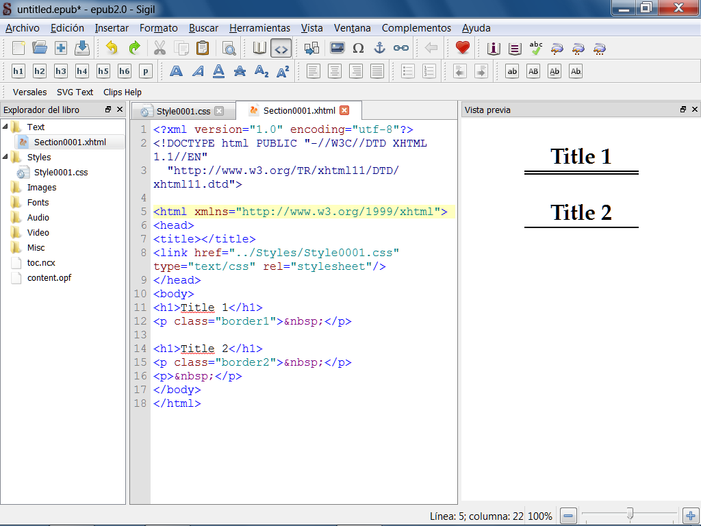

There are many ways to get what you want. Beside the previous answers, you can use something like the following:
1. In your .xhtml file
<h1>Title 1</h1>
<p class="border1">&nbsp;</p>
<h1>Title 2</h1>
<p class="border2">&nbsp;</p>
2. In your .css stylesheet
h1 {
    text-align: center;
    margin: 1em 0 0;
.border1 {
    height: 2px;
    border-top: 2px solid black;
    border-bottom: 2px solid black;
    margin: 0 25% 1em;
    width: 50%;
.border2 {
    height: 2px;
    background: black;
    margin: 0 25% 1em;
    width: 50%;
Here you can watch how it looks in Sigil:
Of course, you can change everything in the "border1" and "border2" classes (top margin, bottom margin, height (thickness of the line), background color, type of borders, border color, width of the lines, etc., etc.)
Regards
Rubén
