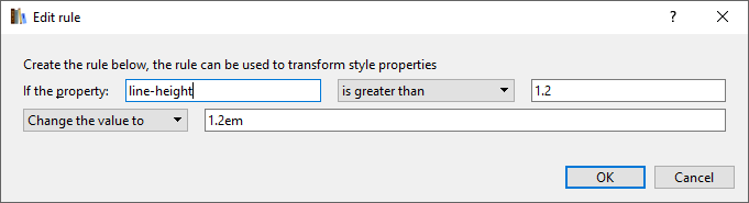

Hi, I do a similar thing, although I remove the line-heights rather than change them.
Attached is an image which shows you what settings you need to do to convert most line heights above a certain amount to line-height: 1.2em (change to suit).
Note the use of unitless 1.2 in the "greater than" field. This will automatically do a conversion for you, and is (roughly) equivalent to 120% or 1.2em.
Hope this helps!
