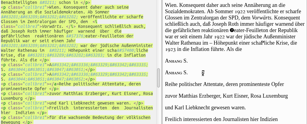

Edit Book: How to remove formattings, here in text?

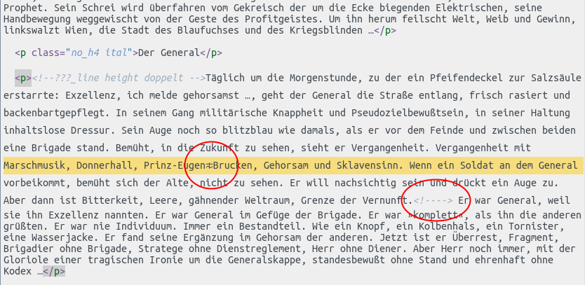

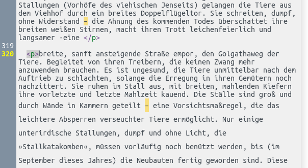

I converted a PDF-file to ePub. Similar to here.
formatted text (Line Heights)
How I can remove these (or best any) formattings in Edit Book, here different Line Hights?
This is quite irritating!
I run Beautify files & Fix HTML, Check Book OK.
The yellow markings are (same sort of) EN DASHs, obviously they have nothing to do with the matter.

This can be caused by invisible characters that can't be displayed in the editor. I've seen this happen with strange quote characters that just don't show up in the editor (some bizarre Unicode symbols that not all fonts can represent). One way to see if that's the problem is to copy the text into an editor that doesn't understand Unicode (e.g. Textpad on Windows), and any non-8-bit characters will show up as "?" or some such. You can also use a regex-function to convert characters above U+00FF to entities:
def replace(match, number, file_name, metadata, dictionaries, data, functions, *args, **kwargs):
    result = ''
    for c in match.group():
        if ord(c) > 255:
           result += '&#%d;' % ord(c)
        else:
           result += c
    return result
Select (mark) the text that looks funny, and do a replace-all on ".*" in the marked text using this function. Then look for any strange "&#nnn;" entities.
Note that the editor is showing you the raw HTML, so it's not an HTML formatting problem -- it's something that's giving the editor indigestion.

Hmm. I'm not sure I can say it any more clearly, but here goes in baby steps:
1) Select the mis-spaced text and press Ctrl-Shift-M (or Search->Mark Selected Text if you don't like using the keyboard). The search range dropdown (bottom line of the search panel) should change to say "Marked text" when you do this.
2) In the "Mode" dropdown to the left of the search range, select "regex function".
3) Press the "create/edit" button next to the "function" dropdown.
4) Paste in the code I gave you.
5) Put "." (without the quotes) in the "Find" box at the top.
6) Press the button marked "Replace all".
7) Change the mode from "regex function" to Regex.
8) Enter "&#\d+;" in the Find box (without the quotes).
9) Press "Find" and look at what it's selected. Does it correspond to a visible character in the preview panel, or what you remember of the original text? If not, delete it and see what happens. Otherwise, replace it with whatever character it should be (whatever it was before you started). You can of course look up the numeric entity code to find out what character it is (just ask Google).
10) Repeat (9) until you get to the end of the problematic text.

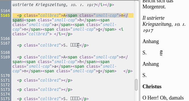

A S. (viewing the typed #numbers is impossible) Textsites configured! The strange character middle left does not appear as code at all.
A → Anhang
S.  →page number wxyz
S.  →page number wxyz+1
As far as the report, evaluation follows (possibly).
Do you want a text part - for your own tests? I will try to manage that.
EDIT: The whole miracles are not yet reported. I have to stop now.

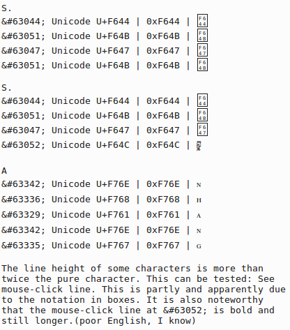

(Et character)#8211; is ''–'' Unicode 'EN DASH' U+2013 (written as HTML Entity (decimal)(not to be confused with EM DASH)
There are lots (dozens) of encodings/notations for something simple??? as an EN DASH.
Private word!
Allow me a private word: At the moment I live in a world (Spain, Jaen province) where it is all about one thing: OLIVES! ... their oil content, harvest yields and achievable prices. Thousands of poor labor migrants (Africa & East Europe) beat the olives from the trees and gather them together. Most likely, none of them will ever know anything more about an 'EN DASH' except the pure knowledge of the existence of such a sign, possibly not even that. - - - No wonder no one can understand the world anymore, and if only as a specialist idiot.
S.
 Unicode U+F644 | 0xF644 | 
 Unicode U+F64B | 0xF64B | 
 Unicode U+F647 | 0xF647 | 
S.
 Unicode U+F64C | 0xF64C | 
A
 Unicode U+F76E | 0xF76E | 
 Unicode U+F768 | 0xF768 | 
 Unicode U+F761 | 0xF761 | 
 Unicode U+F767 | 0xF767 | 
The line height of some characters is more than twice the pure character. This can be tested: See mouse-click line. This is partly and apparently due to the notation in boxes. It is also noteworthy that the mouse-click line at  is bold and still longer (poor English, I know).

The characters you see here are in the "private use" area of the Unicode character set, in other words a set of characters which font designers can use for whatever suits them. In this case, the font you're using seems to render them as small capitals, so having got the entities like &​#63342; (which appears to render as a small-cap N in the font you're using) do a global search & replace:

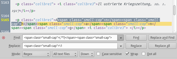

Find: &​#63342;
Replace: <span class="small-cap">n</span>
Then hit "replace all".
Now repeat this process for all the other letters which appear like this until all the problematic entities have been replaced by the corresponding letters wrapped in <span class="small-cap">...</span>. Then a couple more steps:
(1) merge adjacent small-cap spans:
Find: <span class="small-cap">(.*?)</span><span class="small-cap">
Replace: <span class="small-cap">\1
Do "replace all" several times until the number of replacements shown in the resulting message box is 0.

@Phssthpok: What you think!? I am a hard working man ... ... the book is already nearly finish. I found out what stand the problematic entities for (numbers and some characters) and did S&R. Unluckily, so I lost the small caps characters: e.g. &​#63342; appears as normal Unicode N (U+004E).
Then later, I thought, I will correct this, so to speak, self-produced error manually. This is, of course, unprofessional (I hate unprofessionalism). Additionally make possibly overseeing to transform some of the former small caps.
Luckily, before I touch new books for editing I make original copies. So I am able to process your suggestions now:
I merged all Files Browser entries (3.9 MB), then did the instructions in #4 (I didn't have to create the function again, it's stored under Phssthpok). You are linked with ''problematic Unicode''
Replace all: 3.900.000 ocurrences! So I hadn't to do point 8) and 9) of the instructions: the book is full of that stuff.
New problematik: C&P your example &​#63342; doesn't work (Error: Not found). I had to find such a character in the book and C&P that one to the Find-box. Here it is:  - apparently the same!
... must be
Replace: <span class="small-cap">\1</pan>

Why merge them? You can do S&R across all text files, or selected files, or... See the drop-down box next to the Mode drop-down.
... must be
Er, no. Starting with this:
<span class="small-cap">x</span><span class="small-cap">y</span><span class="small-cap">z</span>
My S&R will turn this into
<span class="small-cap">xyz</span>
after 2 repetitions, while yours will turn it into
<span class="small-cap">x</pan><span class="small-cap">y</pan><span class="small-cap">z</pan>
which is invalid XHTML. You should stick to what I told you.

In order to give the code the deserved honor, I have followed 'all' your instructions and can report: You are 100% right.
I have been busy with these books the last time. These are SCANS from two sources, so the scan errors are also different - and almost innumerable.
S&R is only a small help, it is almost always necessary a semi-manual procedure. This is an strenuous activity, if one wants to work quickly and without flaws. (Find-Replace-Find-Find-Replace-Find, etc.) And in the end proof-reading is necessary. I like to deal with texts, so that is a pleasure for me, which would mean a nonsensical and exhausting affair to others. But my temper does not allow to do a job twice.
So I can not start again. Fortunately, the SMALL CAPS are limited to definable, known places: selected headings. Now I filter these out and change to SMALL CAPS.
At the end still a small drop of bitterness (known a few days ago): Small caps does not function in my ereader. Now I write: ANHANG.
A few images and codes of the procedure!

First repetition has 104 occurences, 2nd, 3rd and 4th repetition has 52 occurences (it's clear for why, without explaining here). I test only with ''Anhang''.
  <p class="calibre1">A<span class="small-cap">n</span><span class="small-cap">h</span><span class="small-cap">a</span><span class="small-cap">n</span><span class="small-cap">g</span>   </p>
<p class="calibre1">A<span class="small-cap">nh</span><span class="small-cap">an</span><span class="small-cap">g</span> </p>
<p class="calibre1">A<span class="small-cap">nhan</span><span class="small-cap">g</span> </p>
<p class="calibre1">A<span class="small-cap">nhang</span> </p>
Why [...][generally] the line heights changes (suddenly, without a recognizable reason), yet I got no explanation. However, I can tell that since yesterday evening all line heights reduced to 'normal'.
If I find out, I report.
Yes, so it was, but only because I deleted a particular bad character with S&R.
In #12 I said ... the book is already nearly finish. That we should call a typical misestimation!
Report (as announced): Since some time I know what justified these increased line hights. Responsible are some bad characters, here my collection (so far):                  • ■    ° (isn't º)
Some are optical easyly detectable, others not. These characters influence the line height always the whole paragraph, from <p> to </p>. As I got the 'raw material' partly unedited, some paragraphs are multiple pages.
Prinz-Eugen-Brucken Smart comment tags also limites the bad characters influence.
(Most likely (unproofed) the influence spans from >... to ...<).
So you can probably imagine that the issue made me some headaches in the first time. But even today I find, more and more rarely, new ones.
I have to assume the 'pre-editor' introduced them absolutely intentional to confuse and/or to annoy everybody, who comes after.
