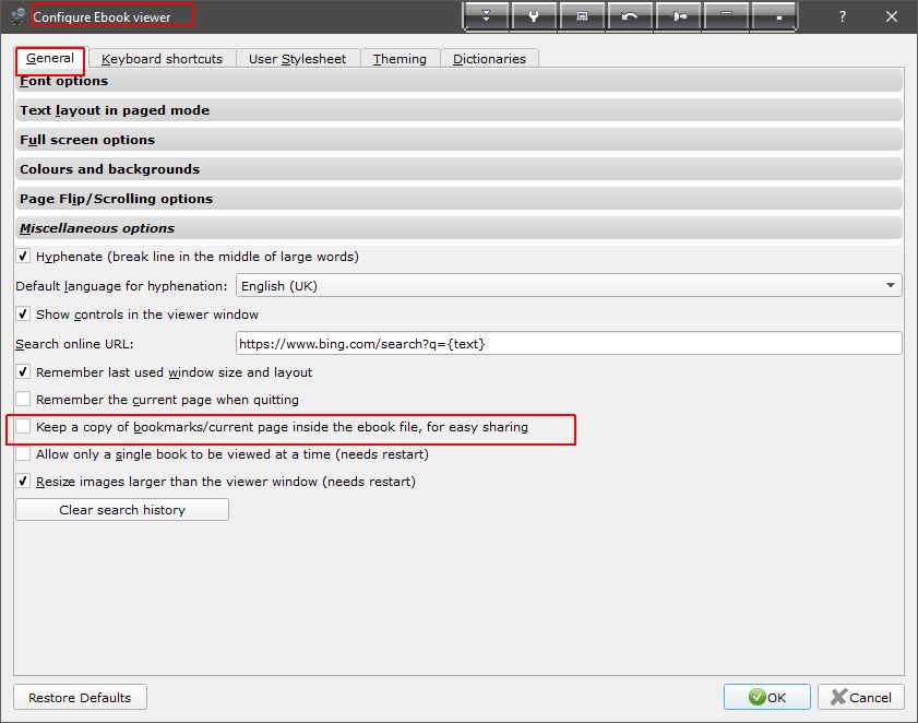

Hello everyone;
I am French and uses Caliber 2.79 on PC win7 / 64;
As a rule I open 3 or 4 template viewer on works that I read alternately during the same day.
In the evening it happens that I lose bookmarks posed during the day.
Would you be kind enough to tell me what protocol to observe to close without losing anything.
It happens to me but I do not know how?
I have not seen any recording option. Should I close the viewers before and calibrate last?
thank you very much

@Cjammi

@BetterRed - Hello,
And thank you;
But I had checked and saw these options before formulating my question, I have the three lines "Remenber last ...", "Remenber the ..." and "Kep a copy ..." which are checked on my viewer and last night The problem recurred for one of the three books read, he finds himself this morning with the bookmarks and reading position the day before yesterday.
So I think this is a certain distraction on my part in the way of closing certain works because I do a lot of work on my machine during the day.
Is there a specific and mandatory way to close template and multiple viewers?
The translation of the French documentation is not up to date.
Thank you - Cjammi

@Cjammi - as you can see I have that option unchecked. Hopefully there is someone who does use that option - with multiple files open - who will be able to advise you best. I would have to experiment.
The word 'template' has a very specific meaning in calibre, it refers to things like this {authors} - {title} which are used in tools such as Add Books, Save to Disk etc. I don't think you're referring to those templates. Perhaps you mean format files e.g. blah-blah.epub, blinky-bill.pdf etc.
I'm sure Kovid would welcome your expertise in improving the French edition of the User Manual, some info here ==>> http://calibre-ebook.com/get-involved

Effectively @BetterRed I see that this option is disabled in your Calibre. I will try on a new work (not yet read) to disable it and to test without opening the others
Yes exactly I wrote very badly when writing "TEMPLATE" I only meant the program CALIBER itself by difference with the viewers.
I believe it was not Kovid who did the French version of the manual, but rather third parties; (That said I can be wrong)
On the other hand I think it's in the version of Caliber itself and translations that some things would improve and may be misled in this place:
English version: "Keep a copy of bookmarks / current page inside the ebook file, for easy sharing"
►►► Wrong translation of the French version (made by a machine like google translation):" Garder une copie de la page mise en favoris/actuelle dans le fichier du livre numérique, pour un partage facile."
Correct translation: " Conserver dans le fichier du livre numérique une copie des signets et de la page courante, afin de parvenir à lire le fichier sur plusieurs support simultanés"
Or shorter but less precise
" Conserver dans le fichier du livre numérique une copie des signets et de la page courante, afin de partager le livre"
