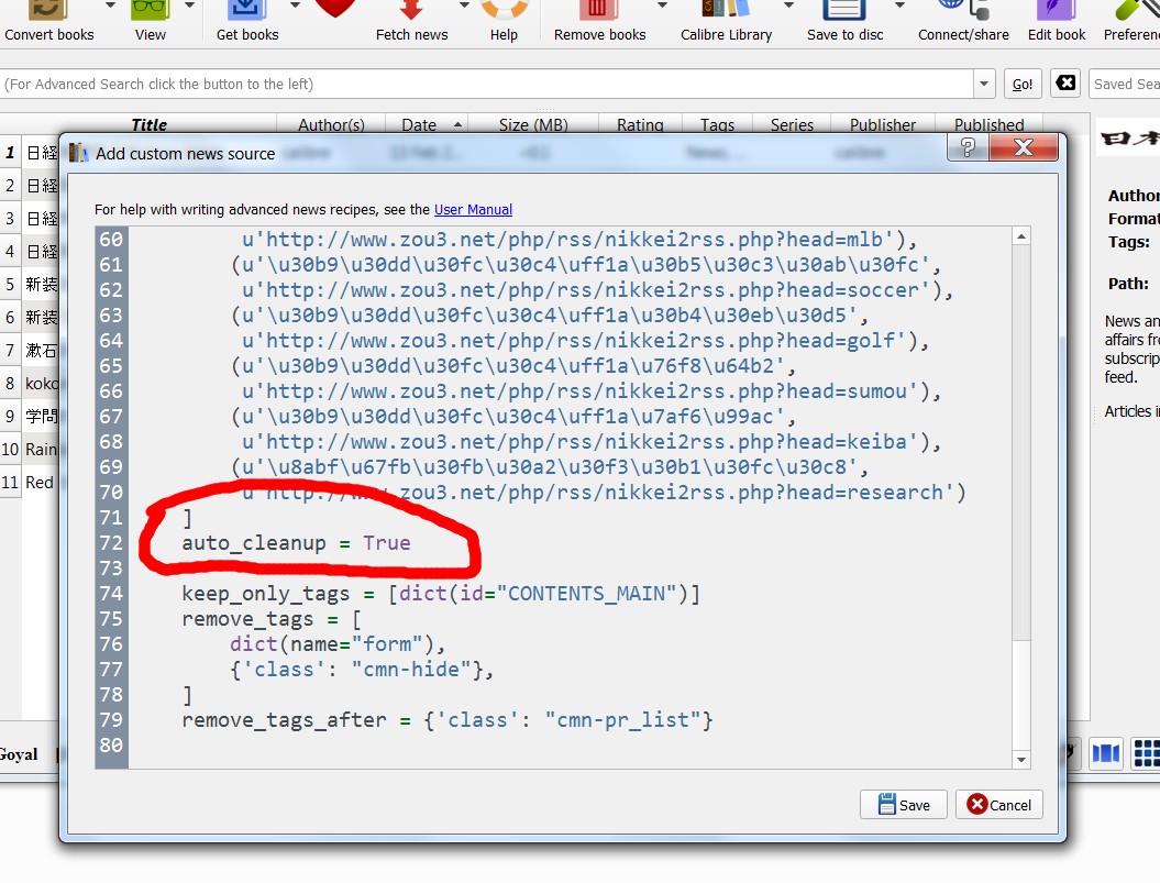

I have no idea what I'm doing but I did 'open' a copy of the recipe and then added the words you indicated right beneath the list of Feeds (see pic). I savd it as a customised recipe but, unfortunately, it didn't work.
The next thing I'm going to do is send an email to the original creator and see if he might help.
