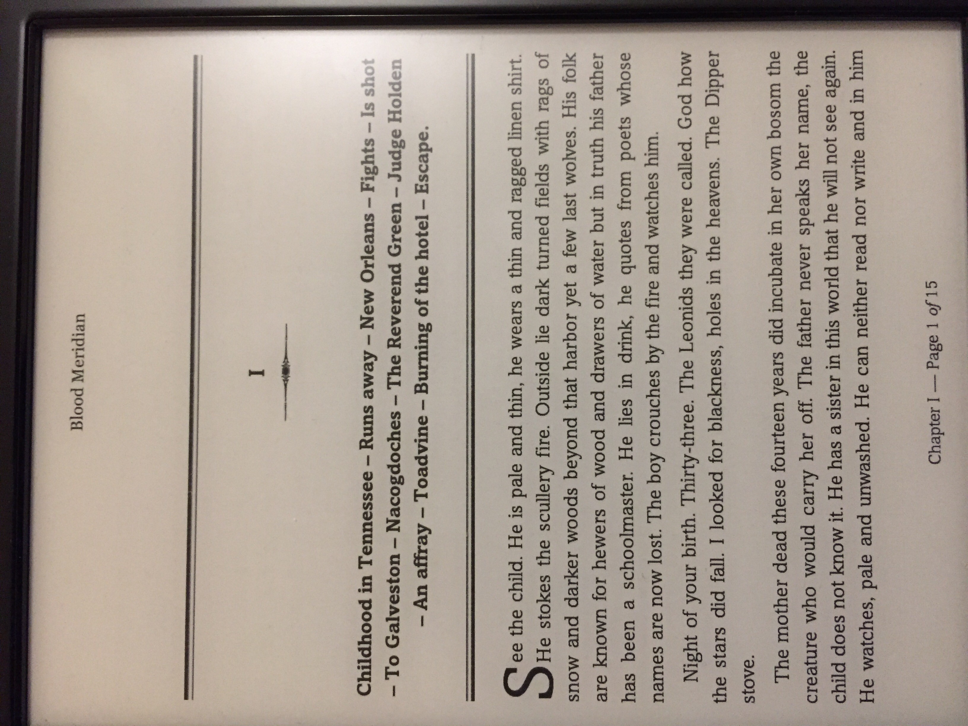

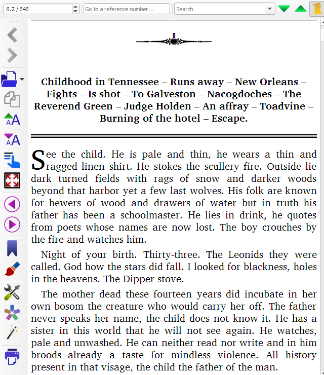

Hi guys. Trying to load up some books on my H2O only to realize that the H2O isn't displaying fonts properly! Especially larger than average fancy letters, you know, the type that begin chapters.
Calibre displays the giant letter at the beginning perfectly, while the H2O puts a space between the letter and the rest of the world. Please see the attached images.
I tried ticking embedded fonts in Look & Feel, and output as a kepub (which I had to rename .kepub.epub in order for the H2O to see it). I also ticked Remove spacing between paragraphs (indent size 1.5 em and line size 0.5 em), made the output profile Kobo Reader and the input profile default. Finally, I disabled inserting page breaks by using a /.
I'm converting from standard epub to kepub in Calibre.
What do I need to do in order to remove the space between the S and the rest of the world on the H2O, and make it one word like it is on Calibre?
ID:	154575   Click image for larger version

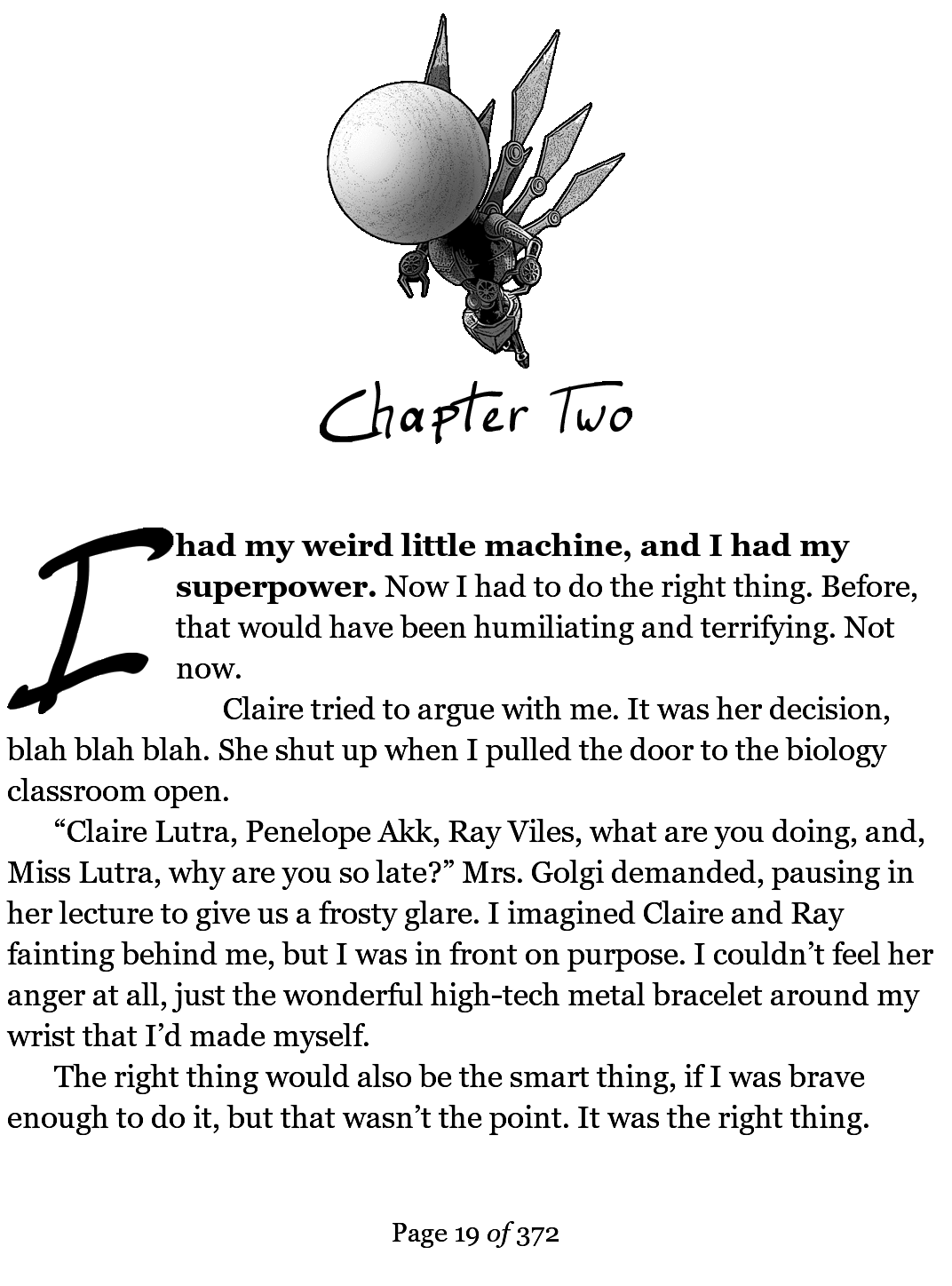

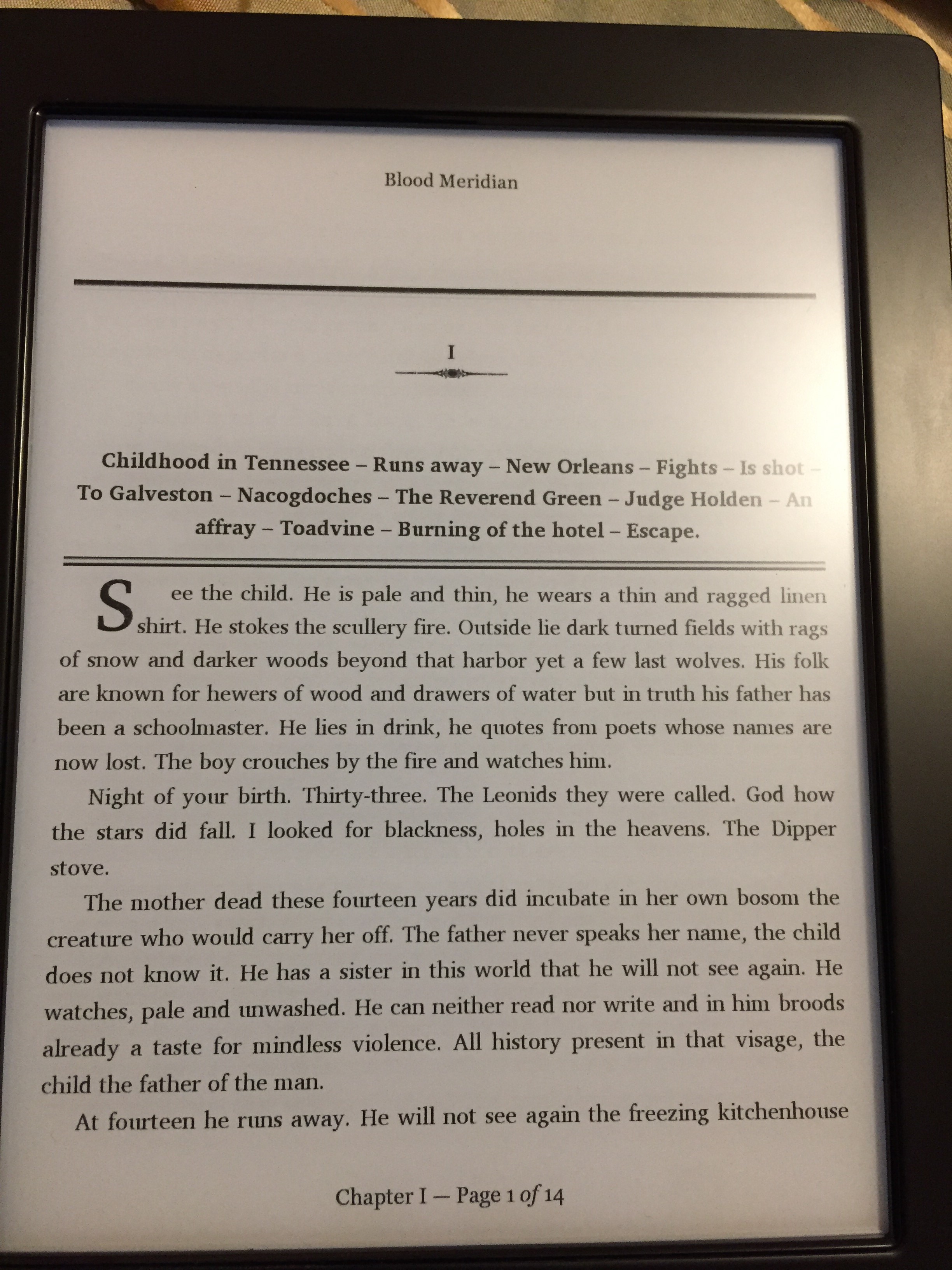

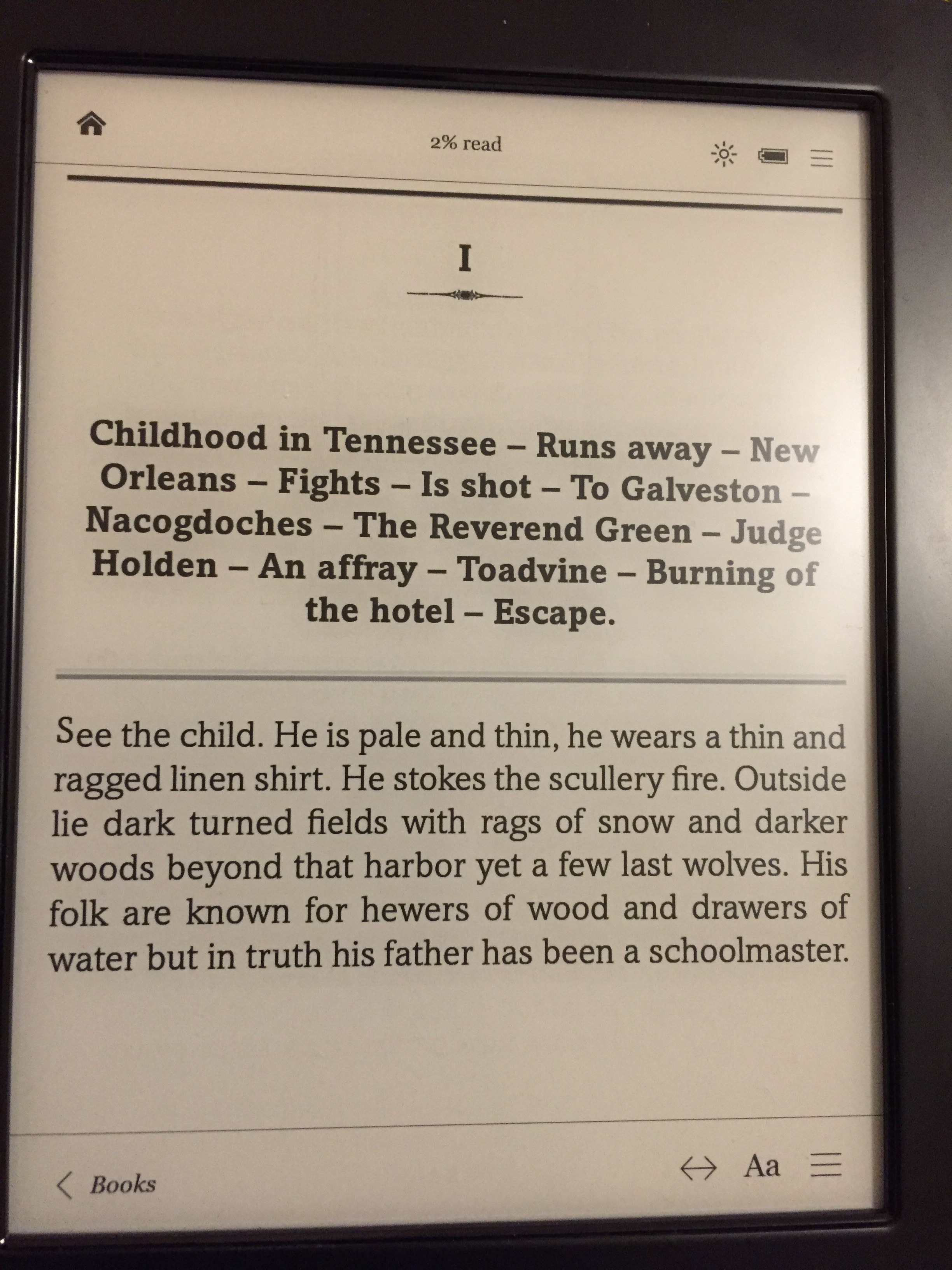

Thanks for the responses, everyone. I'm pretty sure I've resolved my issues once and for all.
The naming issue: that's my fault entirely, and has nothing to do with the Kobo. It's to do with Calibre metadata. I resolved the issue by renaming my Calibre folders.
As for the kepub.epub and epubs not showing dropcase letters properly fiasco: the issue was the conversion options I was selecting. Now I know not to remove spacing or embed fonts.
I now know that the whole kepub.epub thing is only done in order to make nickel treat epub files as kepubs (whether they're the same format in the end, I don't know). I like seeing the amount of page numbers remaining in a chapter, rather than the entire page count, so I like renaming the extensions to .kepub.epub.

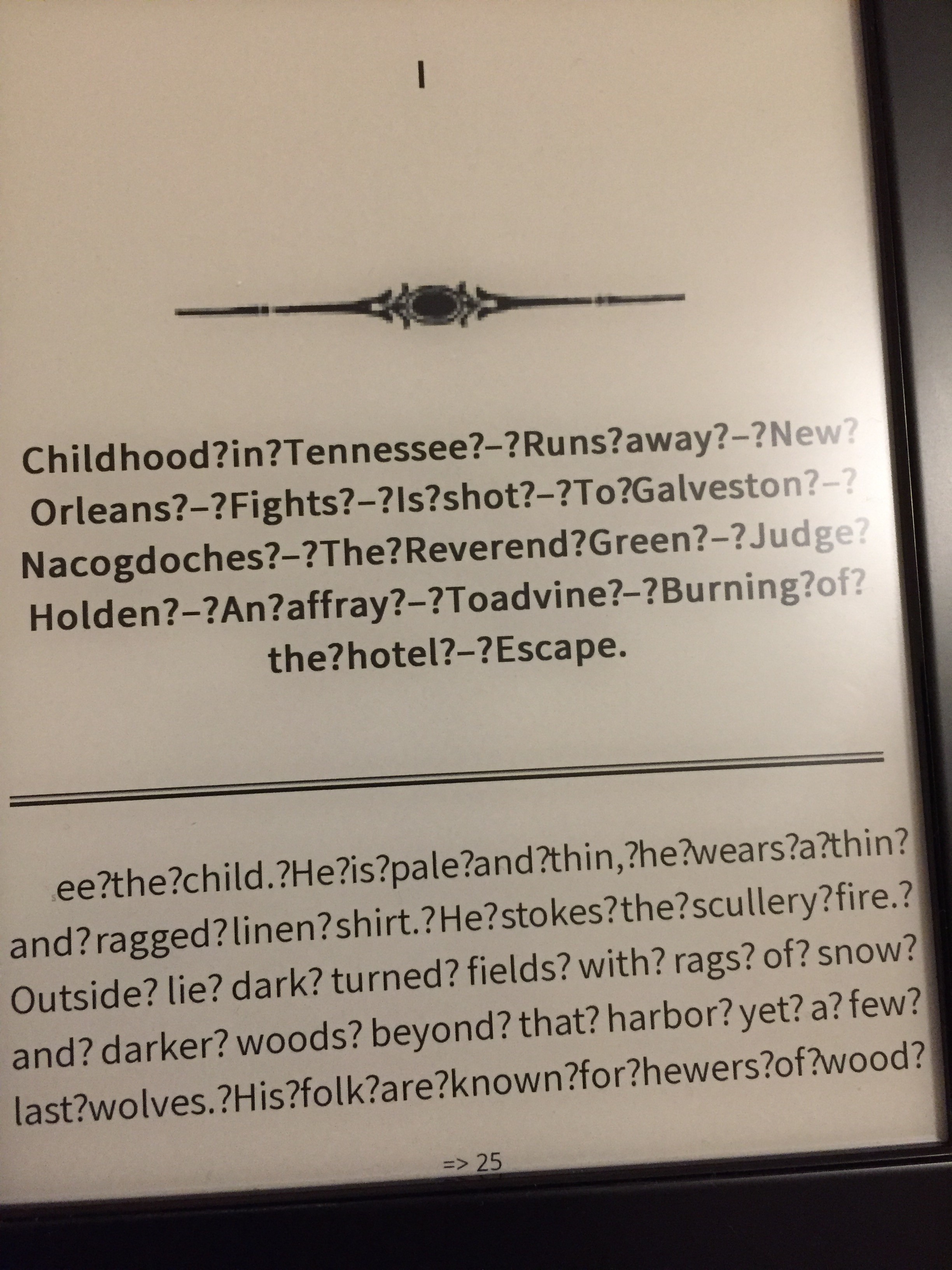

Also, using .kepub.epub with the book I posted in the OP (Blood Meridian) fixes the font problem. See my attached images. epub.jpg shows the .epub version of the ebook, and kepub.jpg shows the .kepub.epub. I have to keep the file as a .kepub.epub to keep the dropcase formatting.
koreader.jpg shows how the .kepub.epub doesn't render in koreader. The .epub displays with question marks, just like the .kepub.epub.
If there is a way to convert the original epub so the dropcase letters render on the Kobo and koreader, please let me know.
Anyway, the steps I took to convert the epub are pretty convoluted and I kind of forgot them (whoops). Involved a few conversions and the Modify ePub plugin. I didn't check the remove spacing or embed fonts boxes.

Thanks for the info. I won't be using those options again! The problem was the space between the S and the rest of the word on the Kobo. Yes, it did render correctly (and I was very thankful for that). I don't know if it was/is an embedded fonts issue or not.
EDIT: Hmm... kepub.jpg won't upload with proper rotation. It shows as rotated on my desktop.
ID:	154617   Click image for larger version
ID:	154619   Click image for larger version
