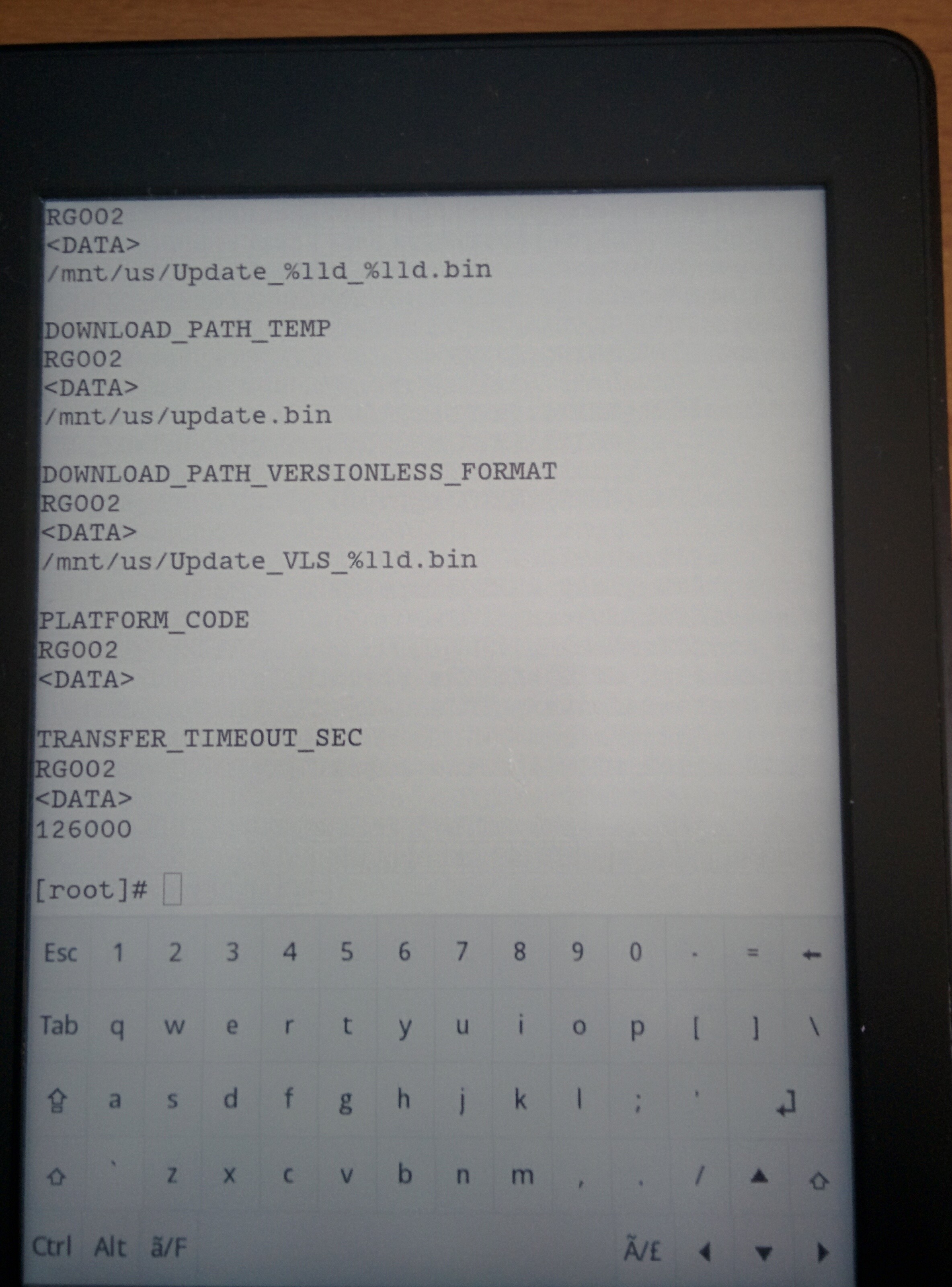

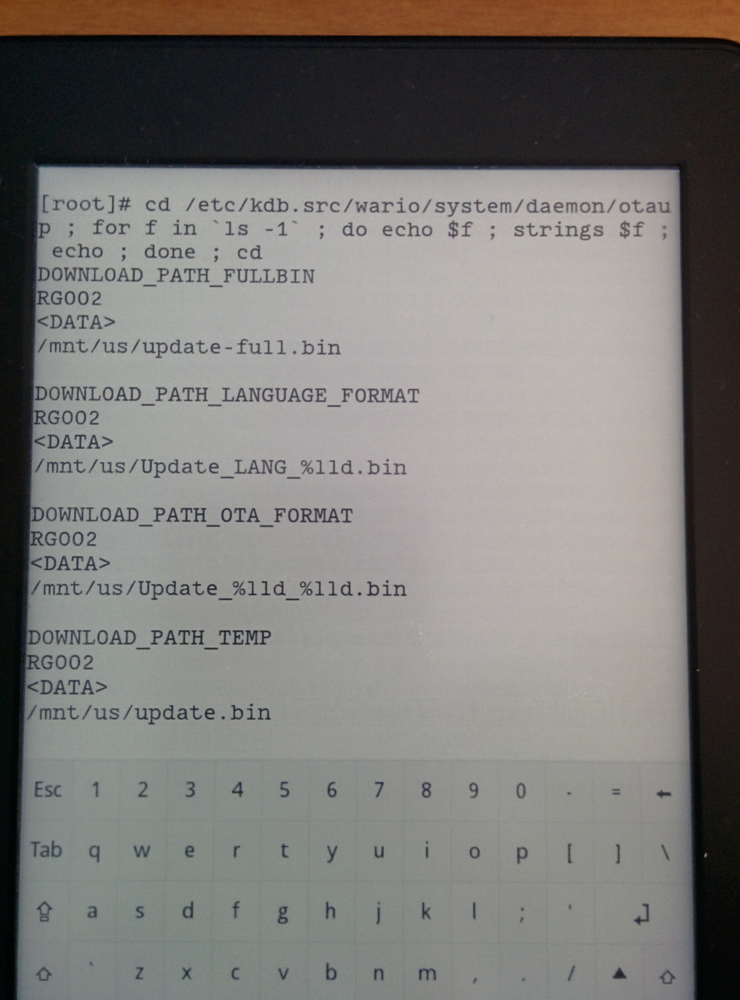

I'm on 5.7.3. (pw3)
ID:	147082   Click image for larger version
