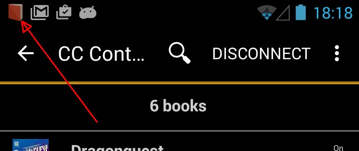

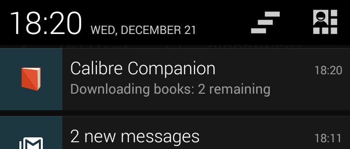

A quick related question... when I use the Content Server and ask it to download all and there are more than a thousand ebooks to download, how do I know when it has finished with the downloading? I have not gotten a message that it is finished and need to scroll though to make certain and that is extremely tedious when we are talking about over 3000 books and only 9 show up on the screen on the tablet. Is there an easy way to know it is finished? The program should know it has finished the download, after all.
There should be an icon in the notification bar that indicates how many books remain to be downloaded. That icon disappears when the downloads are done. See the attached images.
If is OK to kill a "download all". It remembers what was downloaded. A future download all will download only what hasn't already arrived.
