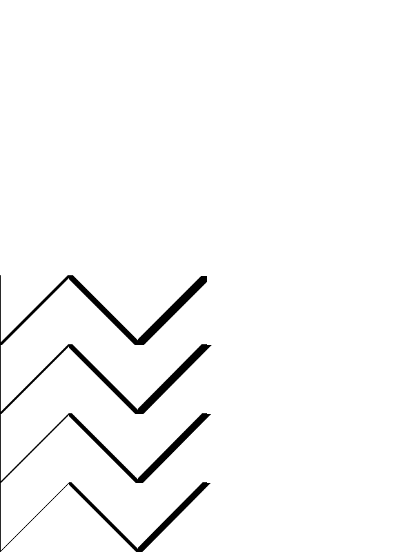

Just wanted to note that I finally found the fastest way to render graphics generated on the device, which is directly to framebuffer. It turns out that if one generates a 4bpp bmp then the exact pixel data of that kind of bmp can be dumped to the framebuffer at /dev/fb0 and will be displayed just nicely, without the overhead of writing to an actual bmp file and calling eips to display it.

sure, attached. The pixel data starts at byte offset 312.
