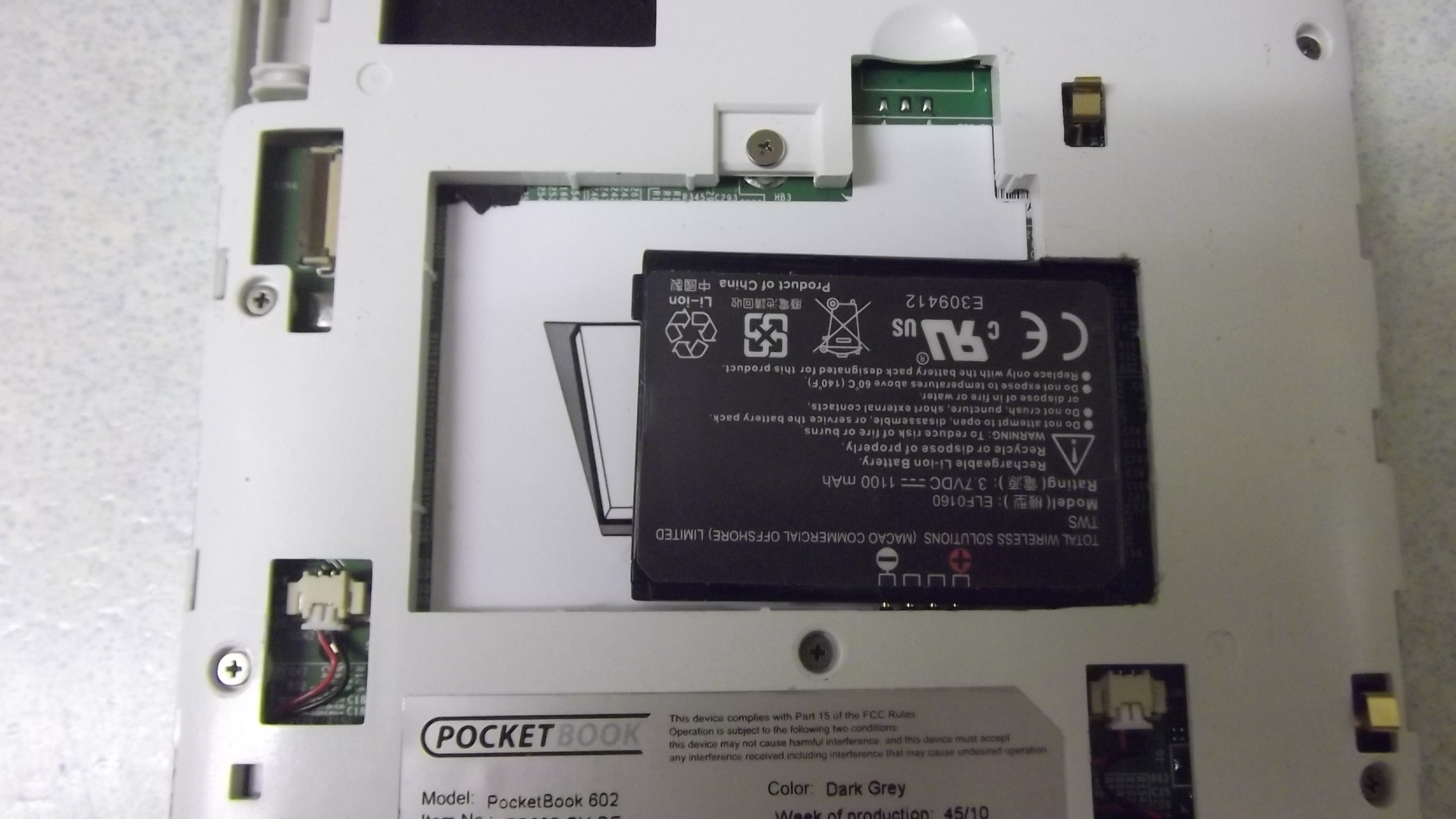

I've just arrived here and have a pocketbookpro 602 with a losing charge original battery i.e only 3 bars at the most and a Cameron Sino replacement that only allows the switch on routine before going to empty. It has been charged fully and have since found out that the CS battery only produces 3.72V while the original battery produces 4.08 V. The battery from the original HTC Touch will work in the pro perfectly but the inner case needs to be modified to fit i.e a bit needs to be cut out of the plastic as the contacts are offset. the battery charges and all the bars are full on the display and the reader works well.

Modification to 602
The benefit of using the htc touch battery is that they can be bought for next to nothing on ebay instead of £10+ for a replacement that does not work properly.

602 modification
Attached is a photo of the battery in position:
