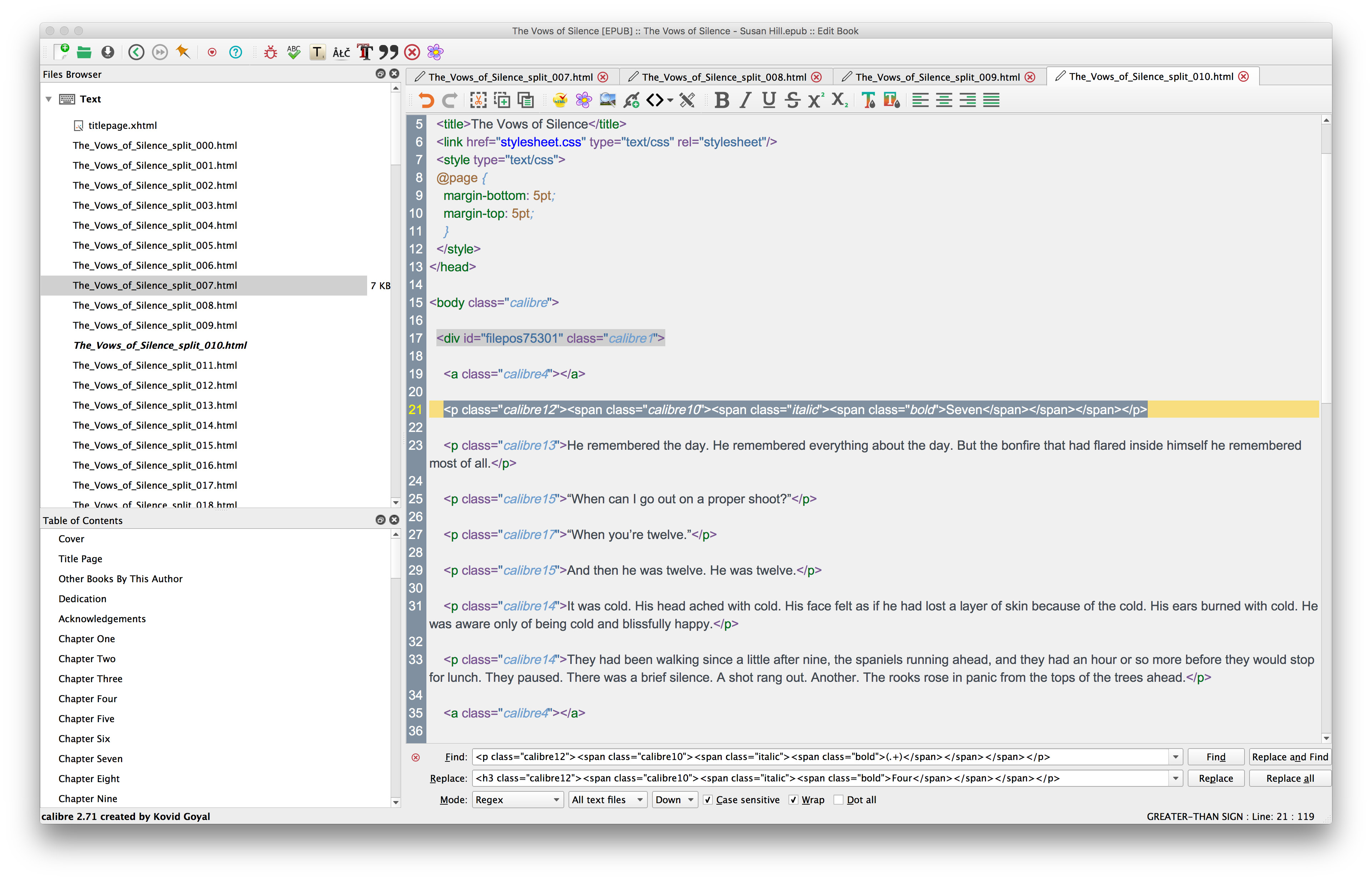

I am searching for this
<p class="calibre12"><span class="calibre10"><span class="italic"><span class="bold">(.+)</span></span></span></p> in the attached file.
The search finds Four in split_007, Five in split_008 Six in split_009, Eleven in split_014 and then circles back to find Four in split_007.
You will see from the screen attachment that these are the files that are open.
When it circles back to split_007 it removes all tabs from the top and only the tab for split_007 shows.
I am using Replace and Find
Is there perhaps a log I can send you.
Also may be of importance, I am on a Mac using version 2.71
