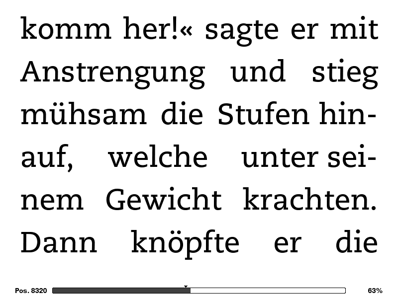

C is already possible by installing JBPatch and the GUI Launcher.
B should not be very difficult either - but it would remain to be seen how usable it is. Suppose that you want a font which is twice as large as the normal one: then there will effectively only be ~1/4th of the "logical" screen real estate available. The menus, book titles etc. might not fit on the screen anymore or be horrible squashed, button text might be truncated etc. So there is an upper "usable" limit for the font size, which remains to be found. Note that this concerns mostly the "OS" user interface; the reader should work ok even with extremely large fonts. See the attached screenshots (the first one shows the home screen in landscape mode; even with the normal font, the last entry is barely seen, and menus, detail screens etc. may also be "cut off" at the bottom).
A should be doable as well, somehow, but will involve more effort.
As TTS has been mentioned: it is already possible to enable TTS on all books usig JBPatch, and there are TTS packages for quite a few languages besides english. Of course, this also (only) goes for the reader application itself; something like a "voice guide" would be extremely hard to implement.
Which kinds of handicap are we talking about? B and C sound like they're meant for people with impaired vision, while A sounds more like a feature for folks with impaired motor skills.

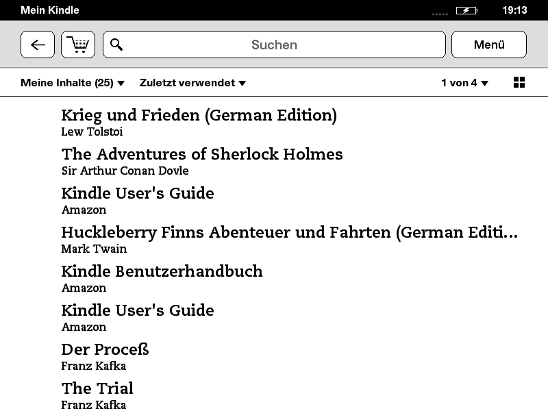

I've played with B a while back, for the K3, and, yes, you hit UI restrictions pretty fast. The Touch has a slightly different UI, granted, but the same kind of restriction applies (it might in fact be worse) .
I think I went with +25% / +50%, and @+50%, it does show issues in some part of the UI (and that was on the K3, which was a bit more 'text' based than the Touch...).
FWIW, and if you want to try it with ixtab's Font Hack, see this post and this one for said K3 stuff .

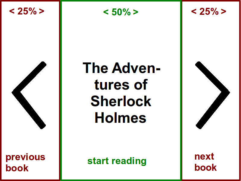

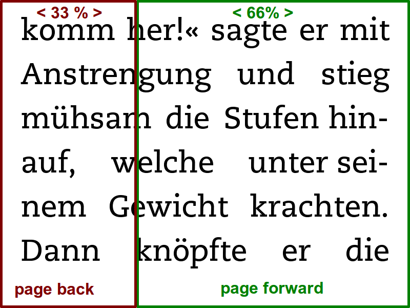

@toka:
Hmm... you sort of caught me with this, so I thought a bit more about it. Would something like the following make sense?
- the Kindle device could work in two modes: "administrator" mode and "user" mode.
- In administrator mode, it would essentially provide the default UI, allowing to change all settings.
- In user mode, only a very limited set of functionalities would be available (1. select books, 2. read book = 1. home screen, 2. reader app), where both would be adapted to special needs.
- To switch between modes, and to support multiple users, the Kindle would have to be connected to a PC, where some kind of (to-be-developed) management software is running. This software could set the mode (admin/user), and set individual user settings (which books are available, reader font size(if needed and differing between users(?)), possibly other settings if needed(?)).
I'm attaching a few "sample" images (the images are totally amateurish because of my absolute lack of talent for anything related to graphics... but the idea should still be clear).
Note: there are quite a few question marks in the above text, simply because I don't know what the actual requirements really are. The sample screens are probably pretty close to what is actually sensible (in the sense of: if even larger fonts are required, then it will become unusable. Smaller fonts should be no problem).
Another question: the Home button is something that is treated very specially in the Kindle firmware (as it's pretty much the only physical button on the device). Since you are saying that a landscape view is preferrable, which means that the button will be close to either the left or the right hand: is it safe to assume that users will not hit the home button inadvertently (i.e., trying to touch the screen, but hitting the button instead)?

@ixtab
Motivation: i work as a teacher in a private alternative school and one of our pupils could use this device. I imagine, that that kind of hacks would be usefull for a lot more people.
We are located in brandenburg, germany.
Custom interface / two modes: yes, that would be the best implementation.
If we switch to "wish you something" or brainstorming mode:
a clear simple logic of the user interface with visual feedback would be best.
The interface block would be a touch zone, which is activated by touching a configurable time. Some visual feedback (a growing bar or pie chart animation) gives imediate response how long to press and prevents inadvertent inputs.
The touch zones could be configurable in a text file.
As you suggest, there could be a "read mode", providing only "back" and "forward".
The best use for the home button in our case would be "go up", which could be me more gradient, say switching from "read book" -> "select chapter" -> "select book" -> "select genre" (cascading set of few options as design principle).
Visual feedback of needed pressing time for the home button would prevent false inputs.
navigation would basically be similar to a simple mp3 player, a cursor with
"left / back"
"right / forward"
"top/ zoom navigation out"
"down/ select / zoom in"
Exactly as you proposed in your images:
three touch zones for selecting content "left","select","right"
and the home button to "zoom out" in the navigation tree.
The navigation tree could be configured by a text file globaly to choose books.
Additional "inner book" navigation could be provided by other text files or inside the ebook.
Switching to /from "easy mode" could be done with some multiple press / morse code interface.
Is it possible to use the usb port as host ?
This would allow to connect a custom interaface by cable or bluetooth, which could be optimized for the persons special needs.
