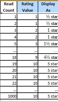

I have a composite custom column #read_count, its template is {#date_read_history:count(,)}
I want to have a custom rating column (#my_rating) that is recalculated whenever #read_count changes.
My understanding is that the underlying value of a rating is an integer between 1 and 10. The attached table shows how I'd like the #read_count column to be used to define a value for #my_rating. I assume I need to extend the #read_count's existing template to compute the value of #my_rating - but I have no idea how to code that.
Could someone help me with it please?

For me, this is not a template but a program (I feel more comfortable with it):
if (read_count < 10):
  rating = (read_count - 1) / 2 + 1
else:
  rating = 10
But I'm not so sure that a rating column could be a composite column.

There seems to be a misunderstanding, I wasn't suggesting the #my_ratings column be a composite column, that's why I wrote:- "...have a custom rating column (#my_rating)..."
I then went on to write:- "I need to extend the [ composite column ] #read_count's existing template [ {#date_read_history:count(,)} ] to compute the value of [ the rating column ] #my_rating."
Should have written, "I think I need to extend"
Regarding plugins:- I don't really want to have my own plugins, firstly I have no programming skills, nor much of an inclination to acquire them, and secondly I would have to maintain them when a change to calibre or something (Qt, Windows etc) causes problems.

Q: Can a template for a custom composite column set the value of a custom Ratings column?
If the answer to that is Yes then:
Could the template of the composite column #read_count be recoded into Program Mode, and could the logic of your code fragment be included it, and if so how ? Maybe it needs a python function - example only: https://www.mobileread.com/forums/sho...02&postcount=1
Baby steps please
If the answer is No, then I need to consider the options - like do nothing.

I already have the columns, see attachment
