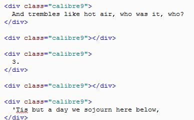

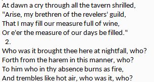

I would like to remove the numbers between lines in a quatrain. The numbers increase up to 500. numbering is punctuated, e.g. 1. 2. 3. 4. ... 500.
The same syntax for removing Roman Numerals from I to CI. (1 to 500).
In both cases I would like to replace the numbers with a blank line.
Many thanks.

Without seeing the HTML code it's hard to suggest a search a proper regex.
Switch to code view mode and locate the number. If it looks like this:
<p>55</p>
select the regular expression mode (Regex) and use the following expression:
<p>\d+</p>
and replace with nothing.
For upper case roman numerals use:
<p>[MDCLXVI]+</p>
Note that you can't use this expression with replace all, because it might also match certain upper case words.
For more examples, see the Sigil Regex thread.

Many thanks for your prompt reply.
I've attached the code for both examples.

For Arabic numerals try:
<div class=".*?">\s*\d+\.*\s*</div>
For Roman numerals try:
<div class=".*?">\s*[MDCLXVI]+\.*\s*</div>
Both are quick & dirty expressions that shouldn't be used with Replace All, because they might produce unwanted matches.
