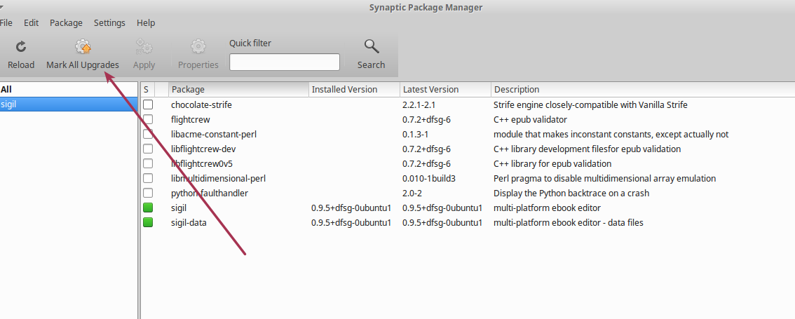

Gregg Bell
![]() ![]() ![]() ![]() ![]() ![]() ![]() ![]() ![]() ![]() ![]() Posts: 2,266
Karma: 3917598
Join Date: Jan 2013
Location: Itasca, Illinois
Device: Kindle Touch 7, Sony PRS300, Fire HD8 Tablet
#10 |
![]() ![]() ![]() ![]() ![]() ![]() ![]() ![]() ![]() ![]() ![]() Posts: 28,915
Karma: 207182180
To have a system that you don't have to rely on me (or someone else) to help you update/modify in the future, I would go the ppa route I described above. That way, system package installing/updating procedures will still function normally.
This kind of stuff not being your forte is sort of why I suggested the path I did. We can go the other route, but it will be more involved, and future updates to Sigil won't be integrated into your normal system update procedures. |
#11 | |
Gregg Bell
Karma: 3917598
Join Date: Jan 2013
https://hastebin.com/lipiwerema.sql I'll do the same on my work computer (where I do most of the work in Sigil) tomorrow. One question I have is that I have Doitsu's Language Tool 0.4 plugin on the home computer but it's not on the work computer. Do you know what that plugin does? Thanks again! I really appreciate it! |
