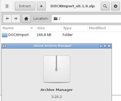

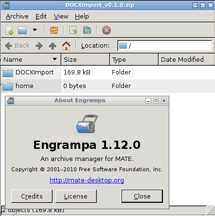

@DiapDealer: This issue might be related to the default archiver that is installed. I was able to reproduce roger64's issue by uninstalling my default archive manager (gnome file-roller 3.20.2-1) and installing Engrampa 1.12.0 (engrampa-thunar).
After I uninstalled file-roller Sigil refused to add the plugin. I.e. this is most likely an unzip library issue, because when I opened the plugin archive file engrampa showed a phantom zero size home folder.
@roger64:
Install file-roller 3.20.2-1 via yaourt -S file-roller from the extra repository and uninstall engrampa, if it's installed. This should fix your problem.
