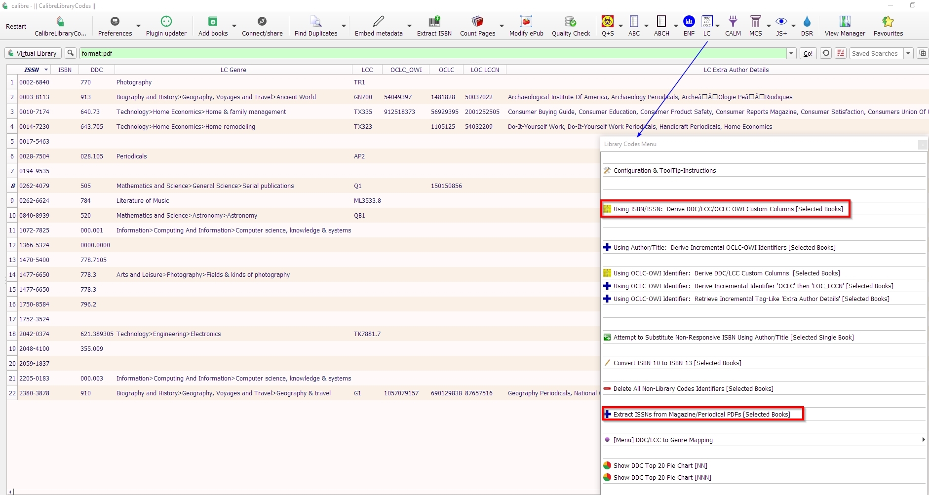

@excalibur:
If your PDFs have an ISSN, the Library Codes plug-in can retrieve a lot of metadata. It can first extract the ISSN if there is one, of course.
See the attached image.
DaltonST

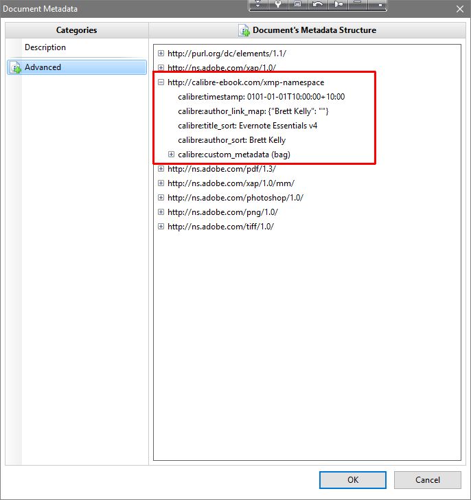

...But apparently calibre is not able to write PDF metadata so any metadata modifications must be done before importing them.
@excaliber - FWIW the calibre Embed Metadata tool will write metadata to unprotected PDFs, it writes it as XMP data so you need a PDF something for Linux that will access the embedded XMP. On Windows I use PDF Exchange, viz:
Added 1 : IIRC Phil Harvey's ExifTool (runs on anything) will see embedded XMP in PDFs, and maybe even allow modification.
Added 2 : Just remembered there's also this ==>> Import Mendeley Documents. Looks like its not working - might be worth asking the PI 'author' if its fixable.
