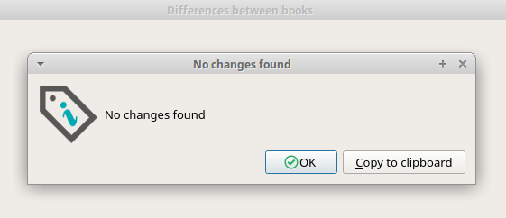

With F&R (Find and Replace) (in MR also called S&R (Search and Replace)) I want to reduce double spaces to one, with command Replace all. I repeated the procedure several times, waited, no changes!
Find: *SPACE**SPACE*
Replace: *SPACE*

Name:	No changes found.png
No changes found In fact, there was also nothing changed.

Old 05-06-2016, 12:31 PM   #2
Posts: 31,325
Karma: 62025226
If in doubt, COPY (select, the ctrl-F) the search value (space pair), the underlying migt be another form of whitespace
REGEX \s\s might work, BUT it might also get line ends

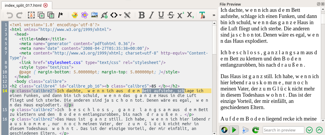

I think the pink blobs in the third shot probably indicate the presence of a 'special' space character. In codeview window, position the cursor immediately after a blob and the character details will be displayed at the right end of the status line.
What does the fourth shot look like in Preview - it appears to have a space between almost every character - but if that's what you want I guess it's OK.
No! What I want is: One (normal) white space between words, none in the words.
Name:	without correction of double white spaces.png
Name:	with correction of double white spaces.png
with correction of double white spaces Looks exactly the same.
To address the issue jackie-w raises you could try replacing the nbsp at line beginnings with a marker, do the global replace, and then replace the markers with nbsp.
??? Further explanations desired.

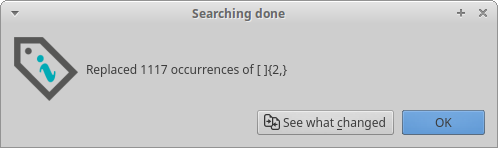

By *nbsp* I meant 'non-breaking-space', a.k.a. the unicode char \xa0 - also often found as the html entity &nbsp;. The calibre Editor Check function will complain if your HTML contains entities. The Beautify function will always replace all html entities with their unicode char equivalent. The Editor visually differentiates normal space and unicode \xa0 by highlighting the latter (as it also does for the mdash and ndash unicode chars to distinguish them from a normal hyphen).
A Regex search for \s will match both a normal space and an \xa0 (and other 'whitespace' chars for that matter, e.g. newline). If you only want to search for '2 or more consecutive normal spaces' then perhaps a regex search for
[ ]{2,}
would be better than \s\s (there's a normal space between those square-brackets)
[ ]{2,}
Brief interim report: Regex functions! And we see once again differences of occurences #3.
Name:	Replaced 1117 occurrences of [ ]{2,}.png
