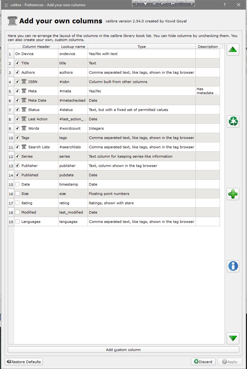

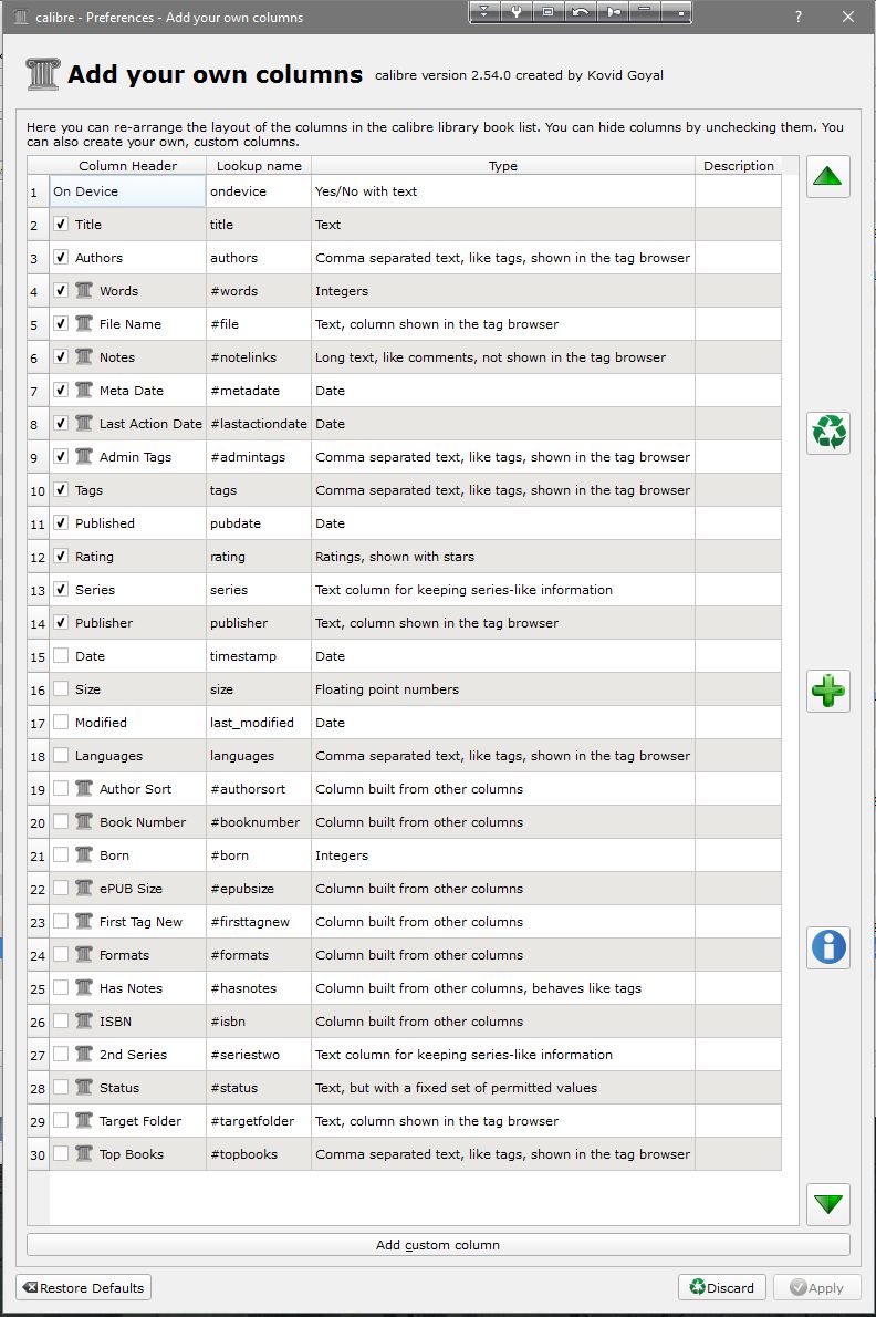

Custom columns are per library - well mine are at least
Test Library Click image for larger version

Books Library Click image for larger version
What makes you think otherwise?
