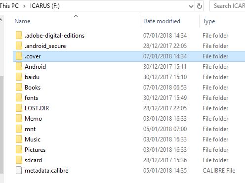

And now 6 hours later everything apart from "reading now" has disappeared from the home screen ( I have it setup for recently added ) I attach a screenshot of the file structure If their is solmething that clashes please say, I am a little suspicious of the fact that there are 2 sdcards /sdcard and /mnt/sdcard
Name:	illumina file system.JPG

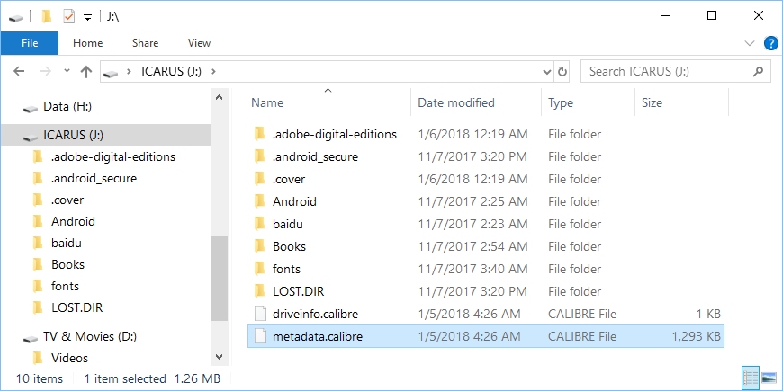

I recently performed an update on my device but attached is a screenshot of my file structure.
Again thank you. I've done the update and everything seems to be working ..... for now! I still have the extra folders in the root directory but "if it isn't broken don't fix it" would seem to aply

Caught in the act!
While reading the screen flashed then opened the home screen and all the books on the "recently added" line had disappeared, the "reading now" part still shows the book I am reading with the cover. I have just opened another book (via filemanager) and it also shows up correctly in "reading now" but nothing in "recently added".
I have now reinstalled the update and deleted the folders that don't appear in DoctorOhh's screenshot and reinstalled the books to /mnt/sdcard/books. The books are there again with covers but a new folder "/mnt" has been added. I deleted the /mnt folder and told calibre to send direct to the /Books folder on the root directory and I now have a mixture of books some with and some without covers. As to the stability I'll just have to wait and see
Needless to say I am very confused!!!
