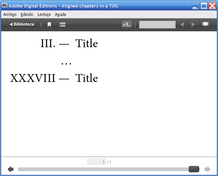

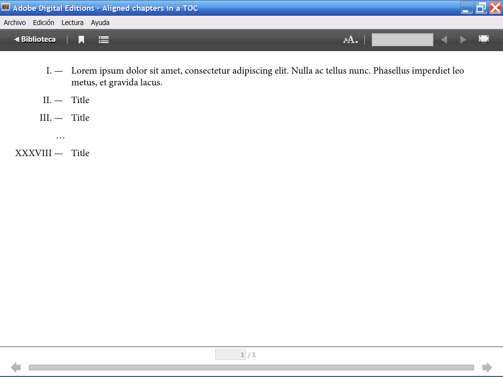

Here there are two screenshots of ADE (with different font-size):
ID:	145589 Click image for larger version
Below you can check the respective epub.
NOTE: As you can see, I styling "inline" the table; that is because ADE has "issues" with styling tables with code in the .css stylesheet.
Regards
Rubén

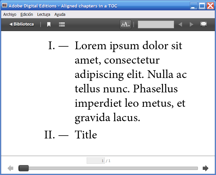

Perfectly fine; at least, in ADE 3.0 or upper. Watch the following screenshots:
ID:	145596 Click image for larger version
