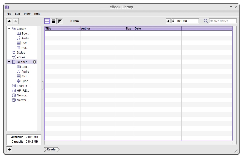

Old 07-25-2008, 02:08 PM   #3
EssKayEss
EssKayEss began at the beginning.
Posts: 9
Join Date: May 2008
Device: Sony PRS 505
igorsk,
Thanks. Tried that just now formatted it as FAT, and when it was disconnected it back to boot/reboot cycle again.
the Sony Library shows the reader as connected (see screenshot)
Calibre does give an error
[Errno 2] No such file or directory: u'F:\\database/cache/media.xml'
but thats because the disk has just been formatted and the directory does not exist. It shows the reader memory as 210.1 MB which is about what it should be.
I have also reformatted in FAT32 (just in case) and it still did not work.
Please help if you can with some suggestions so that I can use the sony firmware updater again.
